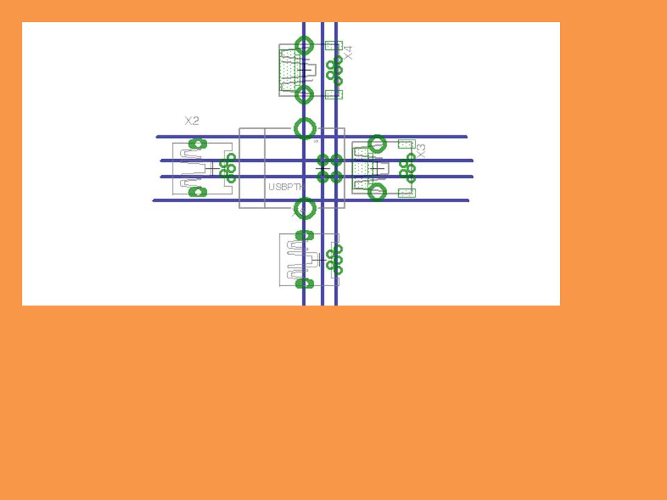

Hello, I have an Arduino UNO revision 3, I was wondering if I could desolder the USB-B connector on the board and replace it with a Mini USB jack? Thanks.
Not easily.
There is a mini-b connector or 2 with thru-hole 'legs' for mounting the parts.
Here is a comparison of the USB-B vs the USB-mini's.
So you could probably get the mounting holes soldered.
You'll probably have to bend the leads up so you can add wires to run down to the holes.

But I think the implied problem is that the USB-B connector is too big and OP wanted more clearance there.
I will bend the leads, I just want to know if you CAN do it and it will work, it´s that here in Mexico USB B cables are expensive, Mini cables are much more affordable.
Yes, electrically it will work.
Personally I think you would be better off cutting the end off of a cable, stripping the leads, and attaching the leads to the boards.
As you can see from the side by side pictures, the mini-b pins will be right over the USB-B pins.
I suppose you could add a piece of heavier wire from the mounting holes and use to secure a non-thru hole mini-b away closer to the side of the board.
