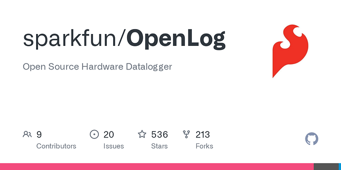

Sparkfun OpenLog allows easily logging of serial data coming from Arduino.
But it's based on ATMEGA328, so question is: can I upload to it my own Arduino firmware to log digital/analog pin values rather than serial input, so turning it into a standalone logger?
I haven't looked at their code, but as far as I can tell they are just logging incoming data to an SD card. So if you have an SD card attached one way or another, a combination of reading the pins, plus opening a file on the SD card and writing to it, would do it.
I'd like to know HOW to look at their code! They say it's opensource.... but as far as I know, they only provide the .hex version!
Where could I find the .pde/.cpp?
And how can I upload my firmware to OpenLog?
I don't know. It seems the GitHub page is wrong. Perhaps an email to SparkFun?
But who cares what it does? They say it's based on the SDFat library, which is available.
I do, because it does not do what I need, but I would like to know if I can avoid buying an SD reader/writer shield AND an Arduino (I think I can).
OpenLog has the needed circuitry to drive an SD card, and it also mounts an atmega328: so why do I need ANOTHER atmega328 to drive it?!?

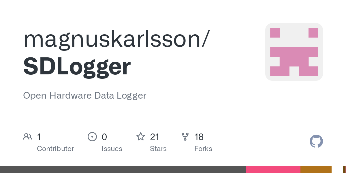

But.... look at what I found! ![]()
http://www.seeedstudio.com/wiki/SDLogger_-_Open_Hardware_Data_Logger

Found original OpenLog source:
12-3-09
Copyright SparkFun Electronics© 2010
Can opensource be copirighted?!?
I didn't notice this line in OpenLog Sparkfun page:
Reprogrammable ATmega328 using the Arduino IDE
So it's ACTUALLY an Arduino glued to an SD card reader. ![]()

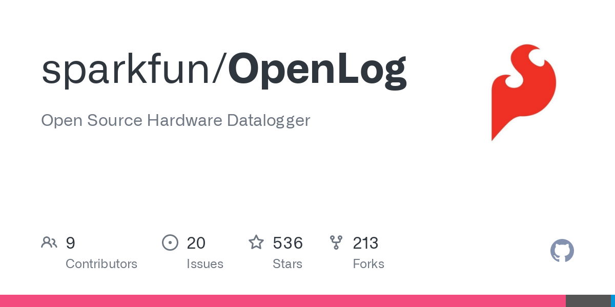

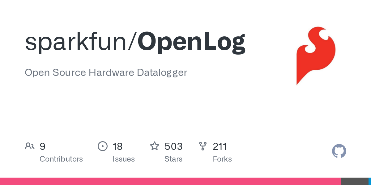

Here's the link for Openlog V3 sources on GitHub:
Old versions also available here:
