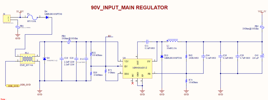

Thanks for posting such a well-described question and schematic.
I'd remove R32 + R39 and simply tie EN and DIM together, but not connect them to any external net, as per the MP9486 datasheet.
The rest seems to quite closely follow the datasheet, with the exception of an extra 100nF cap on the output as well as a 220uF buffer cap. The latter you may not actually need, but it depends a bit on what this is going to power. It likely doesn't hurt much either.
The input section seems to make sense.
Physical layout will be also a (major) factor.

As already said: the layout of your board is also pretty important...
Ground pour, coils at 90 degrees instead of parallel, sufficient separation, sufficient track width.

I will say you will need to put a 0.01µf on the input and output positioned as close to the connector pins as possible. This helps High freq performance.

Galvanic separation is reached with a transformer and sufficient trace separation.

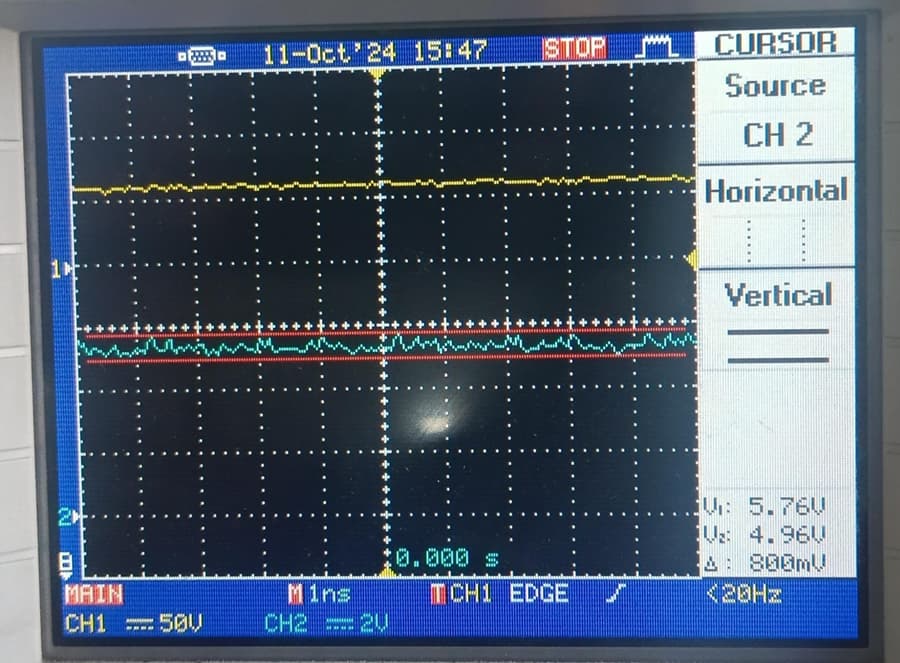

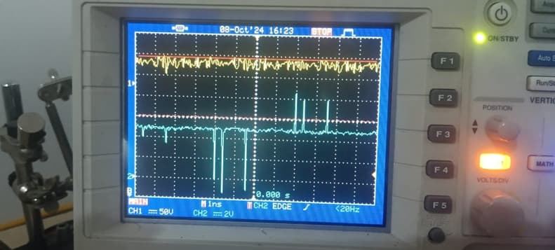

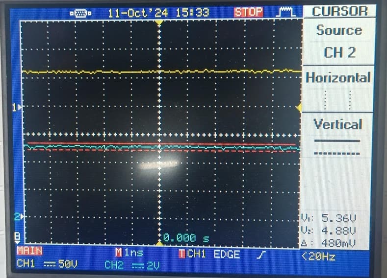

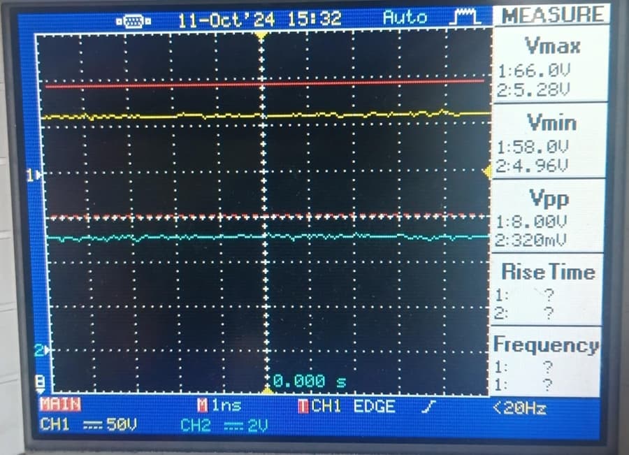

I want to ask one more thing that is below circuit that I'm following the waveforms are below observations
  1. Setup with input Yellow line 60V SMPS output 5.1v blue line
    without load
With load was DC Motor
Conclusion
As per my understanding after testing, we should work on filter and choke to make more effective and also add the zener diode protection to clip the extra voltage spikes at output 5V

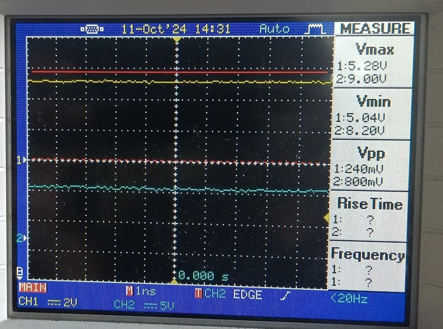

  1. Setup with 12V Input Yellow line SMPS and output line blue 5.1v
Observations:
Observation: Below DSO Image represent the Yellow Input 12V and Blue Output 5.1V
Without Load Condition below image
With Load Condition below image
  • Load Was 1A VTS ( Vehicle tracking system)

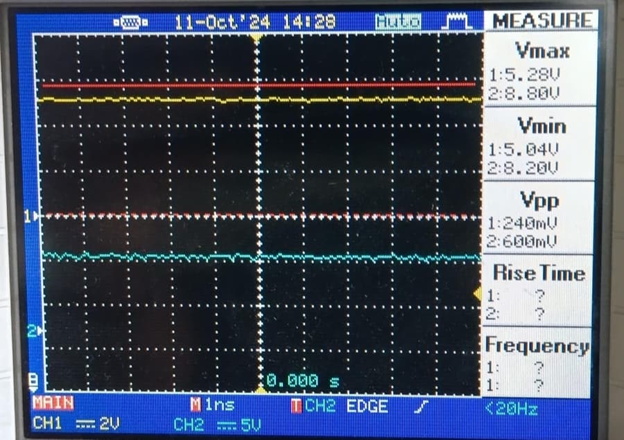

  1. Setup with 8v input yellow line smps and output line blue 5.1v
Observations:
Observation: Below DSO Image represent the Yellow Input 8V and Blue Output 5.1V
With Load VTS below image

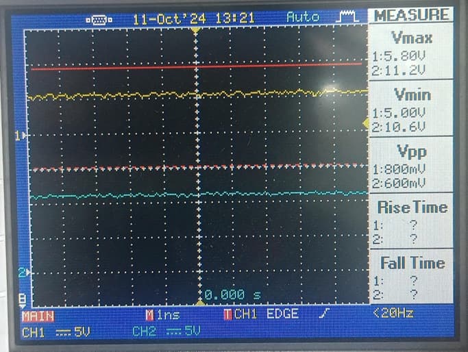

  1. setup with Yellow Input 24V and Blue Output 5.1V
    Observations:
Observation: Below DSO Image represent the Yellow Input 24V and Blue Output 5.1V
With Load VTS Condition Below image

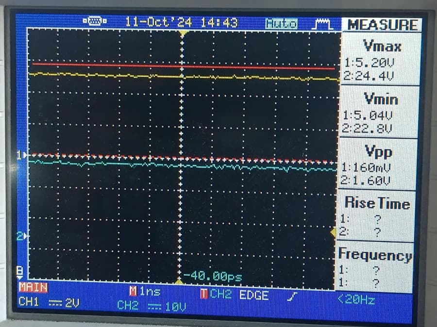

  1. setup with Yellow Input 60V and Blue Output 5.1V
    Observations:
Observation: Below DSO Image represent the Yellow Input 60V and Blue Output 5.1V
as per above waveforms i have some question and hoping that you guys answer
  1. i was expecting that i will get smooth dc 5.1v at output of mp9486IC BUT it has some noise is it normal or i need to work on this if yes then what techniques i should use.
  2. as you can see i already added pi and choke on input but i didn't see the better and filtered output
  3. and this much noise can pass the EMC/EMI if possible please suggest or any setup that i can diy to test my this circuit in lab.

Whether it's normal is not really the question. The first question is how much noise your application will tolerate. If the present performance is sufficient, forget it and move on. If it's not, then you need to identify the sources of the noise and deal with them.
Did you analyze the sources of the noise you're seeing? How did you conclude that a CLC filter on the input was the way forward? If that is indeed the correct approach, did you model the performance of the filter over a relevant frequency range (e.g. spice sim)? If so, have you verified that the simulation parameters are representative of the real-world components and circuit layout including parasitic capacitances, inductances and resistances?
I don't know what the regulations are that apply to this product and the regions it is supposed to be sold in. I also don't see any measurements of the EMI behavior of this circuit; you've only shown us plots of power supply line noise. That doesn't say much about EMI/EMC performance at all. Note that this also involves testing in the actual housing/physical setup of the end product. I see you're presently working with a prototype PCB that's only populated in part. I don't see how you could do a final EMI assessment of this setup.
Please refer to page 13 of the datasheet and the instructions provided for the selection of the output cap etc.
Capacitors are not created equal. ESR can differ from type to type. Parasitic inductance and parallel parasitic resistance also differ, and moreover can vary according to PCB layout.
