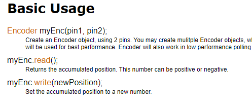

Hi!
So I'm building a Digital Read Out for my lathe using two 1024 p/r rotary encoders. The values are sent to 2 LCDs. There's a switch thas switch the values from inches to mm. So far so good the peices of code I've put together works well but I want more! I'm trying to get the 3 readouts per LCD to be zeroed by pressing their respective button. I've searched for a couple days now but couldn't find any hint of a way to do that. As I'm fairly new to coding I don't know exactly what everything is in this code and what everything does but it does work well so far.
It would be a great idea to go through the code line by line, and figure out what each line does.
You will need to study the library documentation in order to learn how to reset the encoder position. IF you happen to be using the encoder library from Paul Stoffregen, then start reading here.
You have a lot of redundant code there. Also, I'm not sure why you displaying the same value for A, B, and C? A more typical DRO would give you X,Y,Z on the three lines.

I'm using an arduino Uno. And I actually don't want the same values for A, B and C, I actually want to be able to zero each of them independently, each with a button. I've put the same value because it was depressing seeing nothing on those lines, at least for now there's numbers moving... Someday they'll be bent to my will and get zero'ed on command !!!
Rather than have 2 displays that you are dealing with, you should have 1 display with the X axis info on line 1 and the Y axis info on line 2. wire up 2 buttons, one button zeros the X axis, the other button zeros the Y axis.
Here's a hint.
Pin 1 is the serial TX pin.
