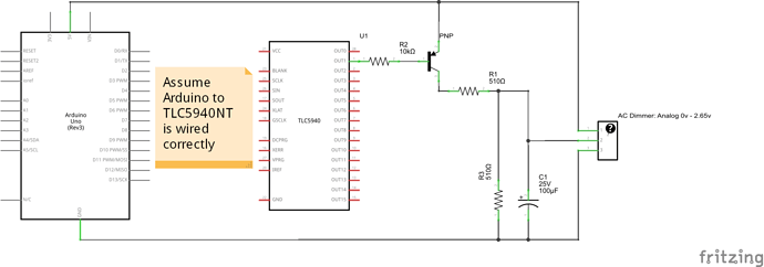

I attached the schematic. Yes this thread is the same project as the other thread but a different problem.

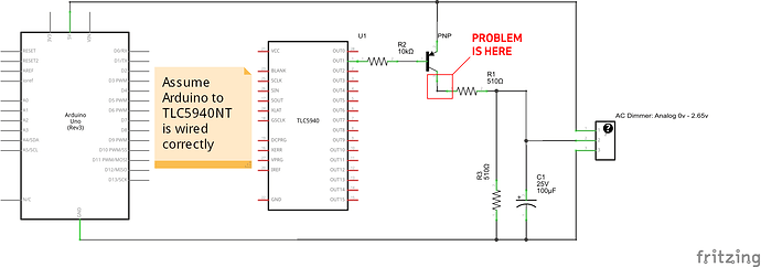

Friday I noticed a trace on the PCB was partially burned out for this particular circuit. I soldered a copper wire in place to ensure a better connection. It was fixed after that but once again when I came in today (Monday) the problem is back.

I can't assume that you have wired the two chips correctly. Can you spend the 5 minutes to draw those wires on the schematic?
10k seems very high as a base resistor. Have you calculated that or are you just copying something else?
Which trace was burned? Are you sure that transistor is still okay? Have you replaced it recently?

As for the 10k base resistor I have not calculated it (nor do I know how to). We tried it and it worked so we went with it. Everything works and the AC dimmers perform as expected besides this one problematic circuit. It's worth noting I've hooked this circuit to different dimmers and get the same behavior and I've isolated the circuit design on a breadboard and the problem does not occur so it seems to be a problem with the soldered circuit.

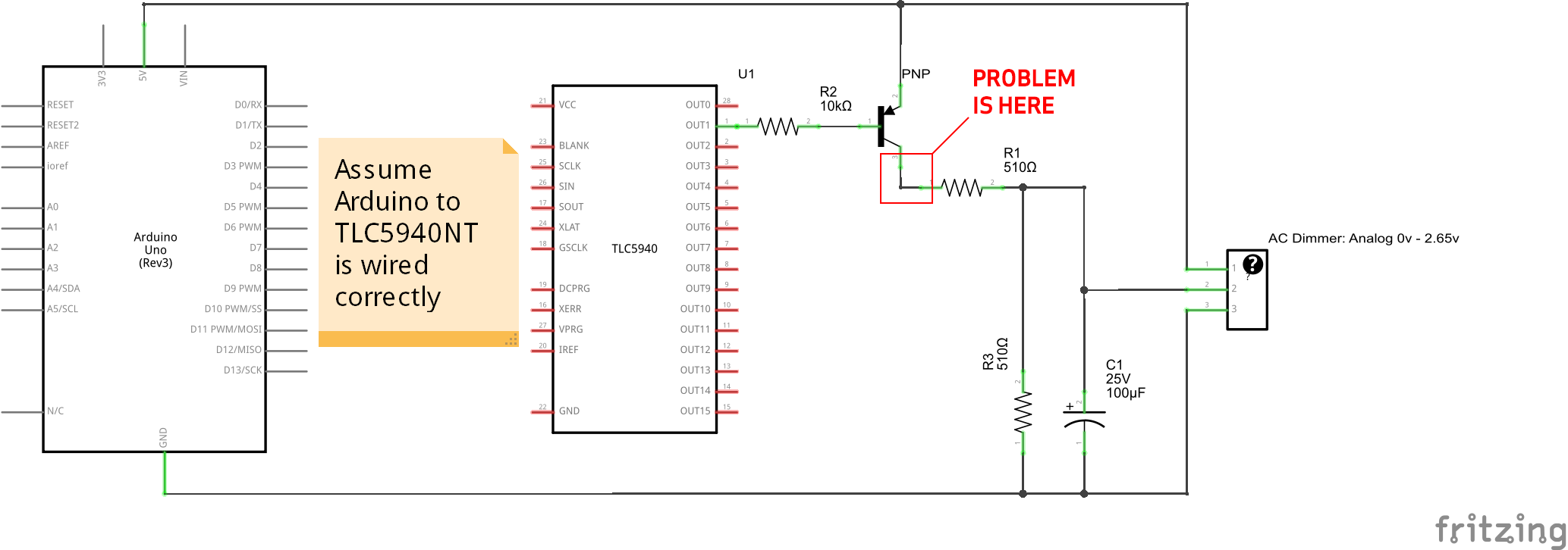

As for the burned out trace I resoldered it again today (with a copper wire) and once again the problem goes away. I'm just not certain whether it will return. The problem connection is between the emitter of the transistor and the 510ohm resistor. See attachment.
Some thoughts... could the problem be occurring due to corrosion over night or something like that? I'm just baffled as to why when I resolder the trace it works all day, then the problem reoccurs the next morning.
I think you mean COLLECTOR and the 510R resistor.

If it fails again, check the continuity between the COLLECTOR and the resistor, BEFORE doing anything else.
The broken track could be the cause, you make the copper expand when you solder, the gap closes.
Over night the copper contracts and the gap opens.
