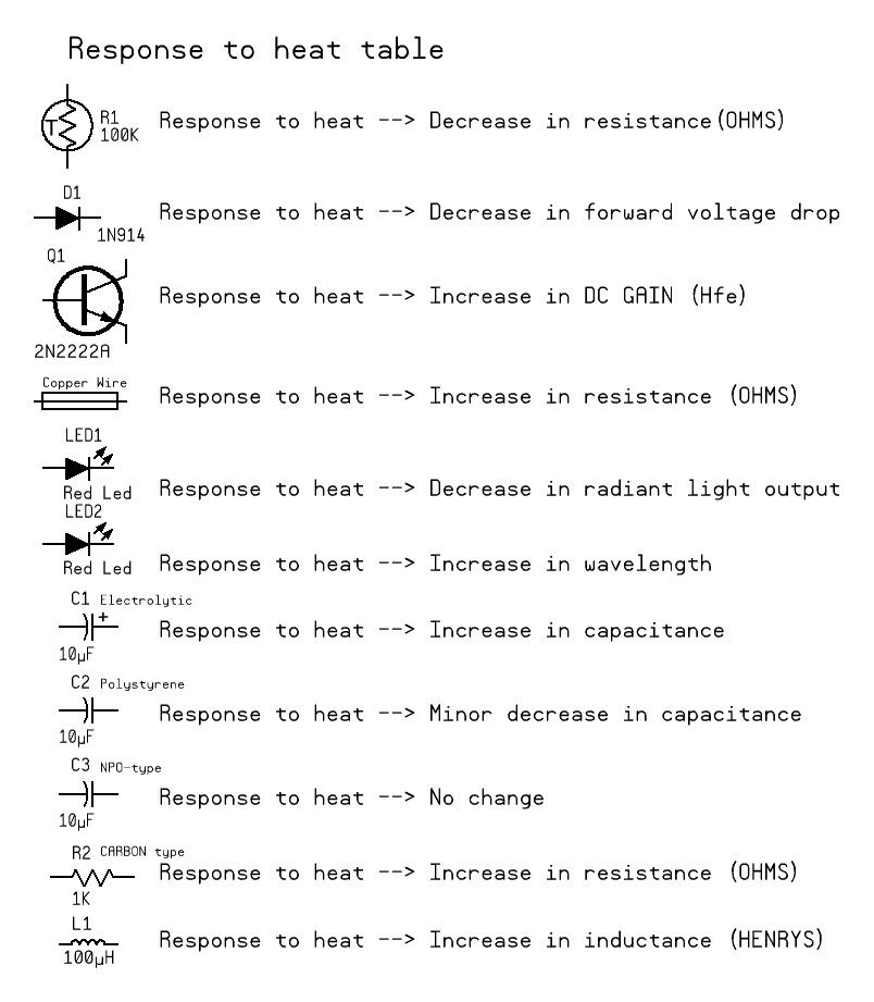

Further information is that as you increase the heat (Power) in a semi-conductor, the resistance increases, which increases the power dissipated by the semi-conductor, which increases the heat... and so on. It can cascade fail. Then it melts and shorts things out or burns them open usually. Also, over voltage will arc through the insides of the part and cause damage inside. This is why you worry about your power dissipation.

Some semiconductors have negative temperature coefficients and some have positive. They do not all react the same.
Usually intrinsic semiconductors have a large negative coefficient as the number of charge
carriers rises steeply with temperature - this is how thermistors work.
Metals and heavily doped semiconductors have a more-or-less constant number of charge
carriers, in which case the temp. co. is +ve as temperature increases the rate of interaction
between charge carriers and crystal lattice (which shortens mean-free-path).

Maybe "semiconductors" was a bit generalized. I was thinking more of bipolars vs DMOS Fet's where the collector current tends to rise with temperature - leading to hot spots, vs the drain current going down with temperature which promotes better sharing in large devices.
A long time ago I did this chart... it might shed some light on what is being discussed.
