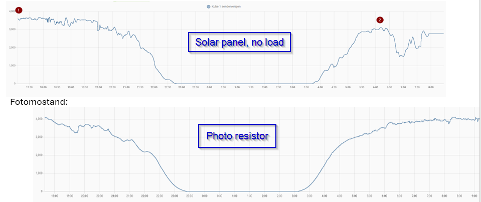

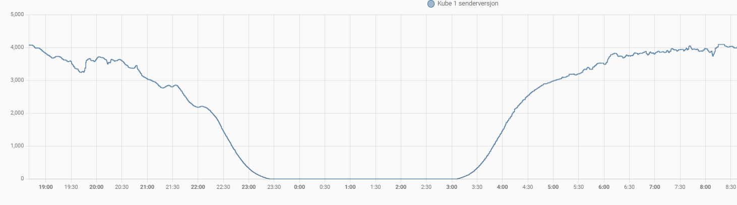

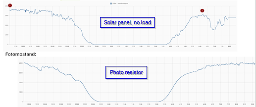

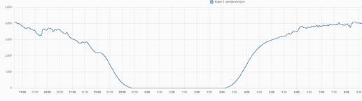

I tested with a photo resistor yesterday, but I plan to use existing solar panel and not add another component to system (out of gpios):
M

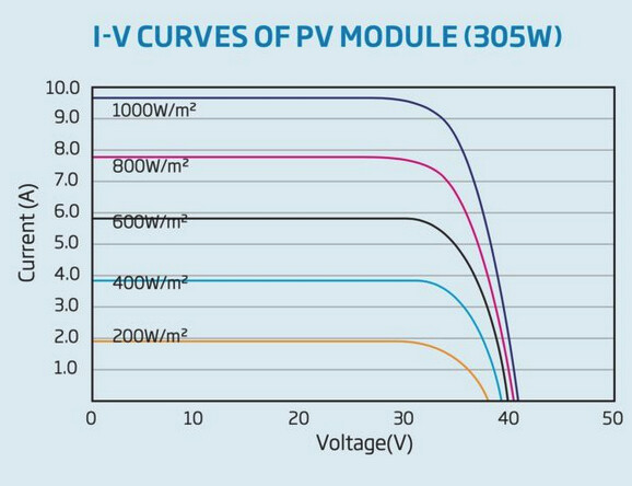

Basically the solar panel converts solar intensity to current (its basically a constant voltage source); and the voltage is mostly dependent on the temperature. Maybe you best stay with the photoresistor?
This may be true, but I experience when not add load to solar it starts in sun like 6V, then goes down to 3v when shade, and to 0,2 when early evening. In real when connected to the system it will charge the supercap or LiPo, ie. a load.
I will hook it up to my system to get a graphical presentation (as for photo conductor) and see if I can corelate the solar voltage output to the photo resistor voltage readings.
My biggest issue is my ESP32 WROOM is out of GPIO/GPI pins, so I really want to do solar volt readings to determine night/day, not add another component.
Any other ideas you have to find a solution for my "problem":
Minus -10 Celsius I can not charge LiPo, only super cap, a not too big super capacitor 5-10F, and I need it to be powered by solar in winter time. I will appreciate any idea!!!
Here is my main tread for my project

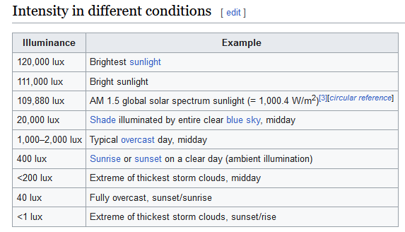

Yes if you are looking at the open circuit voltage it will change a bit with intensity.
And the difference in intensity between full bright sun and dark shade is HUGE
HI, thanks for info. here is the solar panel curve and photo resistor
NB not same conditions, but both days pretty nice and sunny
