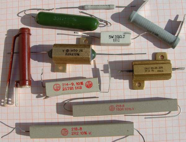

the major difference if your not going to use the resistor in a high wattage application is the case size, 1/16th is tiny, 1/8th is 2x as large, 1/4 is 3x as large as that
course a 1/4 watt resistor is still pretty darn tiny, but after that they start getting pretty big (the largest in this image is 1 watt)
Never seen 1/6 watt resistors, 1/4 watt are pretty small. Yes you can use higher wattage resistors than a spec calls for. They make interesting smells if you overload them so be careful that they are big enough for the job. If you seriously overload them they can be very interesting........

So, just choose from these, if you wanna change between funny smell and funny appearance...
:slight_smile:
They aren't resistors, they're electrical heating elements.......... :wink:
