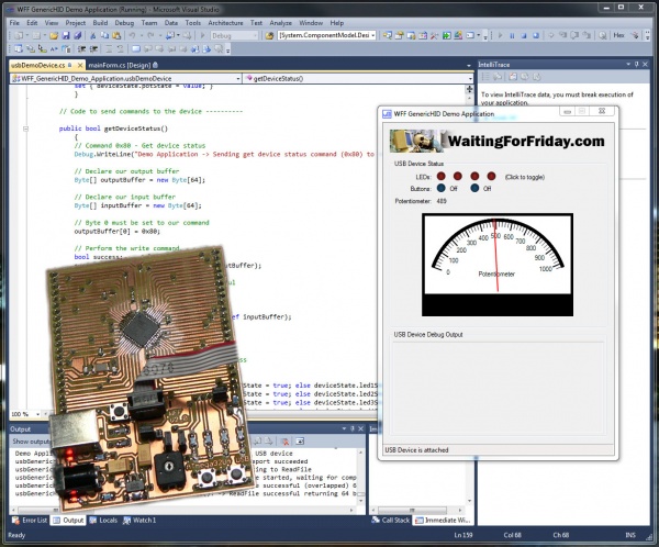

Ha ! very interesting. Thank you all for your time. Could you recommend and alternative USB communication library (maybe a driver as well?) that will work for the Micro?
I don't know but all I can suggest is searching for "ATmega32u4 usb library". Quite a few hits there. For example:
Maybe LUFA:
Of course these libraries may or may not address the concept of powering down the processor. I would have thought that for that to work the host would have to be notified (similarly to when you unplug a USB) and maybe there is just one bit that needs to be tweaked in a processor register to make it work. However I don't know which bit that is.
Maybe here:
This looks promising:
