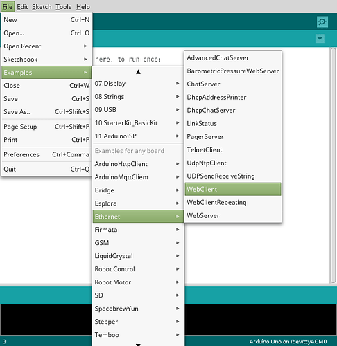

Thank you for your response. Can you please specify the library used and how to define objects? I understand that's basically a complete code request, but I kinda stuck, I will be very thankful.
From what you wrote it seems that I only will be able to send info to EthernetClient, can you elaborate on how to send it to EthernetServer?
it is the Ethernet library. it has examples in IDE Examples menu
Oh, right, sorry
Those would do, right?
Thank you, I'll go try
Thank you for being patient with me. The ping-pong sending works, I'll go add some meat to the skeleton
