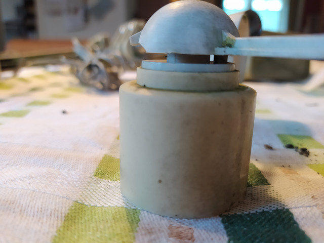

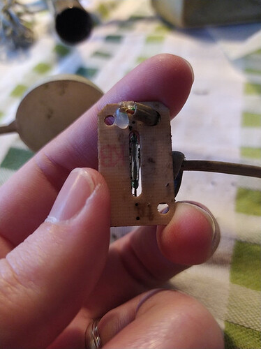

I have found an older anemometer, it only has 2 wires and works via magnets I guess...
Is there a way to make this work with an Arduino? It would be a great addition to my weather station I'm making!

Yes. That should be easy. It looks like it uses a magnetic reed switch. Wire it up to the Arduino as a switch. Count the number of pulses in unit time (ignoring bounces), then do a calculation for the wind speed. This will also be a function of the length of the rotor arm. Be careful about very long wires to it which might cause electrical instability.
Hard to tell from the pics but it appears to be just a reed switch, probably actuated by the magnet(s) whizzing by.
You could plug it into an Uno (e.g.) -- one wire to GND and the other to pin 2 -- and try this:

The built-in LED should toggle states if the output is switching "on" and "off" as you rotate the thing by hand.
If that works then the unit is likely compatible electrically. Whether or not you can translate the pulse rate from it into a calibrated wind-speed is another matter.

It works! :smiley: That's so awesome! Thanks for the code snippet.

I hope you have the third arm somewhere! A hail storm last year broke off one arm from my anemometer. Tried industrial super glue, but didn't last.
I drilled both pieces with a tiny drill and broke a steel needle to get a short length and super glued the needle piece into each plastic part and then held the pieces together until the glue set up. Has been working for about 8 months.
Haha, sadly I've had the same problem with this one, which is why I put it in my shed. I didn't find a solution at the time to keep it in place securely. At the start of this year though, I've bought a 3D-Printer, so I'll be printing a complete new top, with arms attached. I hope that that will last for some time :slight_smile: Thanks for the tip though, I'll try it if 3d Printing it became impossible.
Unless you can print with UV resistant plastic, you won't do any better than your existing device. It is NOT UV resistant plastic as can be seen in the pictures.
