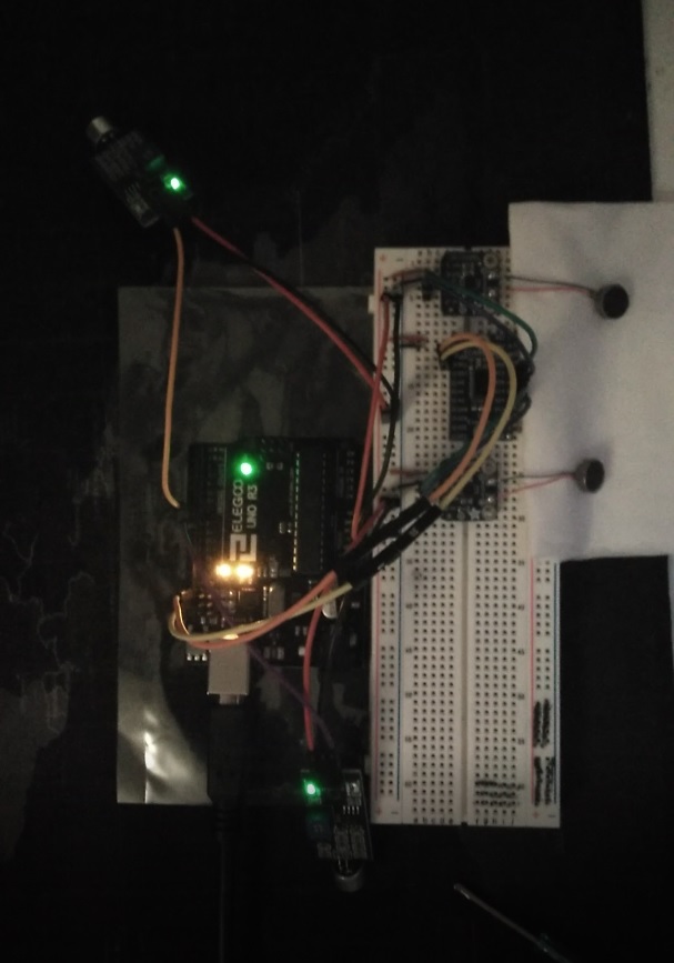

Sorry, this circuit is just one piece of my project. My goal is to create a sound-to-haptic feedback wearable vest for deaf people so that they can experience sound through vibrations on their upper body.
I’m using binary sound sensors around the vest to capture sound from different directions and store binary input values in short intervals so that I can compare all recorded inputs and activate motors on the appropriate side of the vest based on the highest recorded binary value. So let’s say that the highest recorded sound was captured from the sensor on the back and motors activate on the back, so they turn on and off one-by-one in a sweep effect.
So far this peice code successfully captures binary inputs from 2 sound sensors and selects the highest captured value, then activates a motor. The code seems a bit simple but I’m ok with that.

This is what I have done so far. The idea was to get 4 DRV2605, link them to the Uno through a multiplexer and replace that one motor on the motor controller with 3 motors in parallel, switched by MOSFETs. These DRV2605 controllers are quite expensive, that’s why I wanted to use an alternative method.
