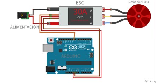

Revisiting a LIPO/Motor setup
Someone on this forum posted the below drawing about 3 years ago with questions about choosing the correct power source.
The DC motor I am using is not robust enough to handle the load of a small propeller, so I am considering moving to a LIPO/brushless motor setup. I am a RC flyer so I am familiar with the ESC/BEC with the typical input of the data pulse to the ESC is between 1000uS (zero power) to 2000uS (full power). I have two questions.
How do I setup the PWM output in the code, say pin 9, where the width of the pulse indicates the desired power level (1mS to 2mS)?
The earlier OP was told to use a separate power supply to supply 5v to the arduino. Why, if the output of the BEC on the ESC is 5v?
Thanks for your time.

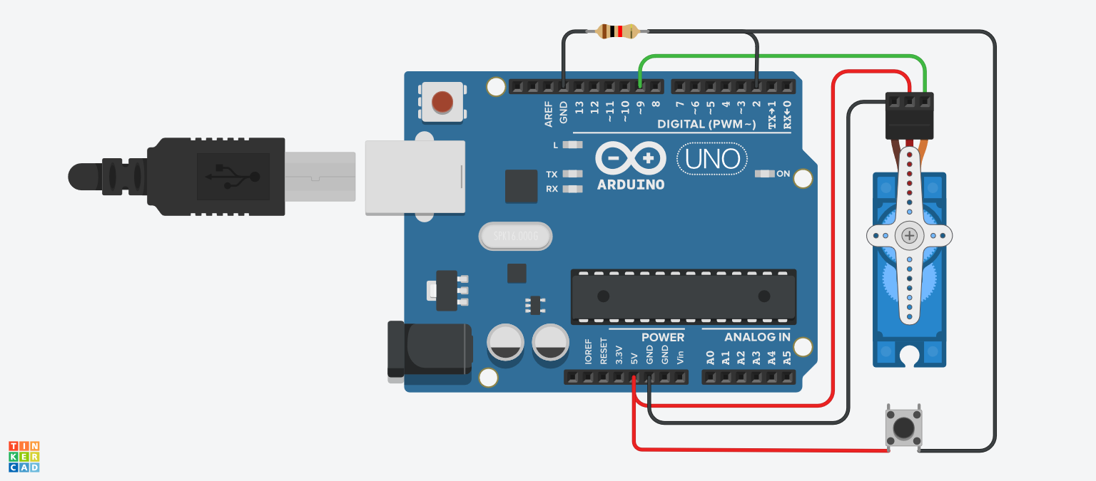

Just use the servo library. It generates the required signal on ANY digital pin, and that pin does not need to have PWM.
Maybe because of noise in the power supply but that's just my suggestion.

I am a beginner and I am trying to take a sketch (code) that worked on a DC motor, but need to upgrade to a brushless motor and now need servo control to increase and decrease the motor RPM. I want to merge the bottom code (example sketch) into the below code and I feel like I am trying to put simple code into advanced code and am not sure how to proceed. A big thanks to LarryD for the major help with this project. The code that is currently working is here:

Instead of a DC motor, I thought this example code may work for my ESC/BEC controlled motor, but not sure how to include it in the current code. I still want to ramp up (from zero to 90 in steps of 1), hold, and ramp down the motor. Probably a delay (poor choice of words) of 65mS between steps, to make the ramp up slow to full power in ~6 seconds.
The schematic is a very simple one and this is my first attempt at constructing one.
Thank you very much for any help you can give me. This is a project for lifting a Balloon for a Area 51 train layout, and now a pumkin balloon in a spider web bowl. Its for the kids.
