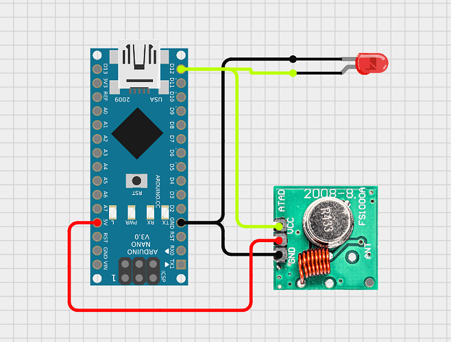

Hi, I want to test my RF 433MHz modules transmission by LEDs. This is the digram and code of the transmitter module:

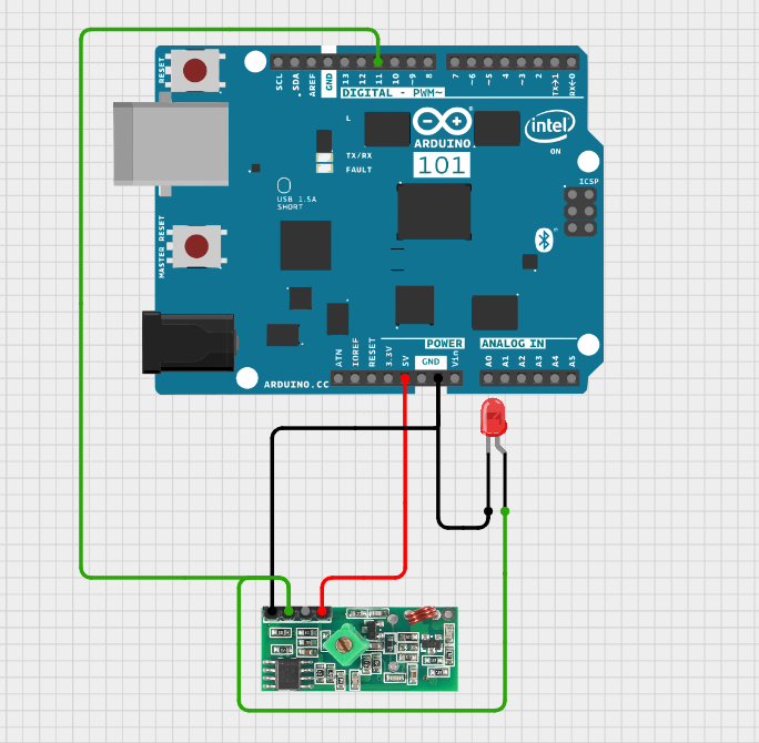

And this is the receiver:

Remove both LEDs from your circuit, Arduino pins can't be used to supply current for LED without series resistor. And especially it can't supply current to transmitter AND LED.
Neither can receiver.
Also, tx pin needs to be 12.
It must be a mistaken when I transfer my real-life circuit to digital diagram. My real-life tx pin actually connects to pin 12, so I have edited it.

You have Vcc going into the transmitter's input, and an output pin where the TX expects power.
You can run the LED and the data off one pin, but as has been pointed out you need a series current limiting resistor for each LED. But you won't learn much from that, other than confirming that you haven't blown out an output pin along the way.
It is not clear you have not made the same kind of mistakes with the receiver.
Hope that you have not irreparably damaged your module.
Post a schematic of how you have actually hooked things up. Draw it with pencil and take a picture, that will be easiest and fastest and give us confidence that you are accurately describing the wiring.

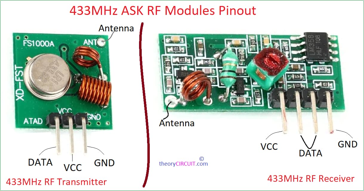

Afaik VCC on these goes to the middle pin and input is.. ..ATAD.
The labeling is just so chinese...
I do not quite understand what do you mean by this. I just connect them like this.
It might be misprinted or something.
Or ambiguous. I see how they may have meant the labels in your first picture.
That's the nice thing about standards. So many to choose from. :expressionless:

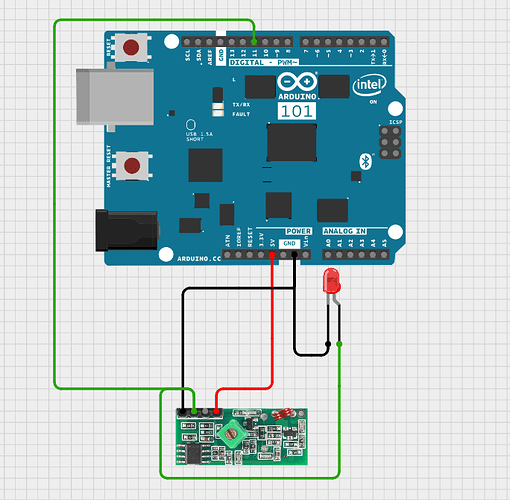

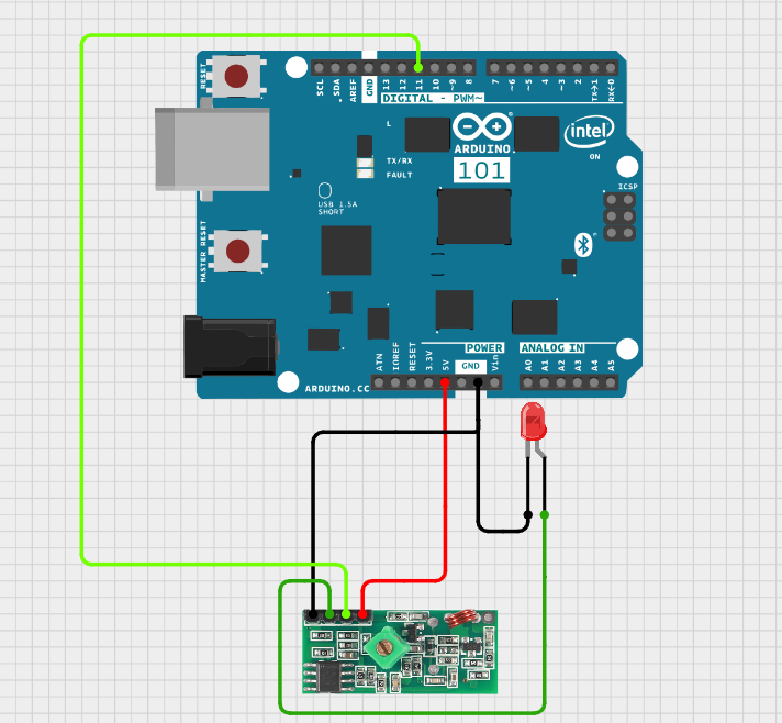

Updated: I have removed the LED from the transmitter after re-cheking the schematic. Also, I changed the connection of the LED in the receiver into the images below since there are 2 data pins of the receiver which can work seperately.
The remaining LED still blinks after each 0.1 seconds as same as the transmitter's code. However, the serial monitor still displays "No data received".
You can NOT connect the LED to receiver output pin.
You really want to fry your components on purpose?

Also, I want to know why cannot the LED connect to the receiver's pin. The LEDs seems good and blinks as the transmitter's code delay.
First, please confirm you have a series current limiting resistor, not just the LED.
Second, without knowing for sure, it is reasonable and safer to assume that the output of the receiver may have limited current supplying capability.
You can't even be sure of what the output circuit looks like. Just read it with an INPUT or an INPUT_PULLUP and drive the LED in sync on its own OUTPUT pin.

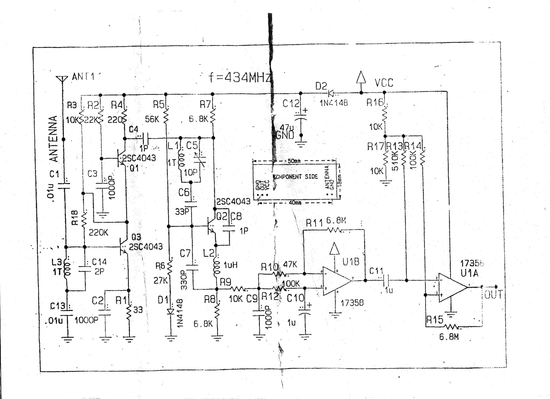

To whom it may concern, attached is a possible circuit diagram of the receiver.
Of course, it is one of many available for purchase, but I hope it provides an idea of its output.
From my experience, all those who use an LM358 have the same output configuration.
