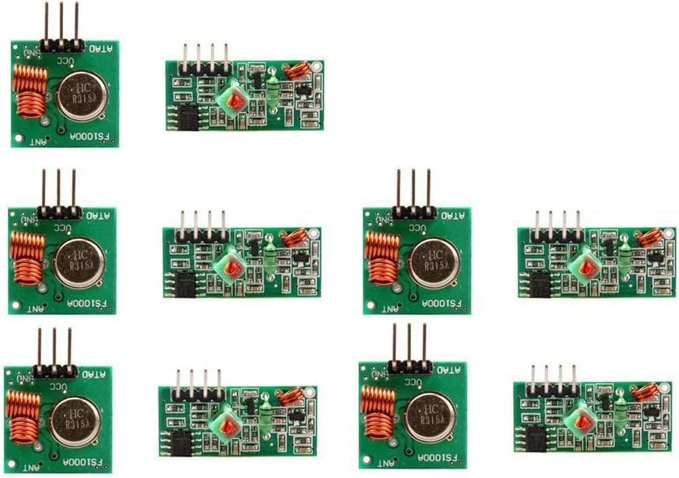

Im working on a DIY project to build a door alarm security system. For this I would be using pro mini’s to trasmit data from door sensors over RF to a Uno acting like a hub. I am using the regular 433Mhz transmitter and receiver.
On breadboard test, I am getting a range of max 20ft. I have soldered a thin copper wire of 17cm as an antenna on both receiver and transmitter. On doing some googling, people claim they get a range of 30-50 meters with a 17cm antenna. And Im struggling to get 20ft at line of sight without interference. In my living room the range dropped to 10ft. I kept the antenna straight up on both receiver and transmitter. My transmitter circuit is using 9v battery and receiver is hooked up to the laptop.

What 433MHz transmitters & receiver are you using as the quality/range can vary so much between makes/models/designes.
Its very much dependant on which '433Mhz transmitter and receiver' modules you are using.
There are such modules, low cost, that will have no issues going through several walls, although of course it depends on the walls.
Some '433Mhz transmitter and receiver' modules can struggle to do 100m line of sight, others are good for hundreads of kilometres.
This is what im using. Sorry i should have mentioned that. Im using ASK libraries.

Also, the receiver you are using is a superegen type and these are the worst possible type you could pick as they have the worst sensitivity and the worst immunity to interferance .
If you want to use these cheap OOK radios, at least use the superhet type , which can be identified by having a crystal on the PCB .
The superregenerative receiver used in the setup shown in reply #11 works very well, indeed far beyond expectations, and is more than adequate for the job.
