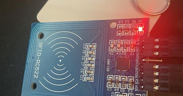

Hi all, I'm in the process of creating an RFID booking system with Arduino if anyone has any support they can offer for this and I'm currently encountering an error with this (please check attachments)
Many thanks!

Seem to be getting the issue:
Firmware Version: 0x0 = (unknown)
WARNING: Communication failure, is the MFRC522 properly connected?
Scan PICC to see UID, SAK, type, and data blocks..
Let's wait for a helper having detailed knowledge about those things. I don't se where that message would come from.
Highly time for sleeping here, 4 AM......
Now expain, in detail, how you have everything wired.
This is my pin wiring:
SDA | Digital 10 |
SCK | Digital 13 |
MOSI | Digital 11 |
MISO | Digital 12 |
IRQ | unconnected |
GND | GND |
RST | Digital 9 |
3.3V | 3.3V |
OK- I also need to know WHAT MFRC522 board (With a link) you have.
I just had a look at your images, you need to apply flux and resolder the pins, I would not trust that soldering.
