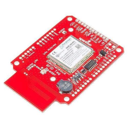

Hii, Im trying to make a rfid system using arduino, I bought An antenna (840-960 MHz EPCclass1 gen 2 iso 18000-6c) and suitable tags, but I understand that I need a reader.
Do I really need one?
How do I know what reader do I need?
So you have any suggestions from where to buy it?
Thanks.
Link to what you bought?
What is the 'antenna'?
Usually you buy the reader/writer and some cards or fobs...(together)
That is a UHF RFID system. Yes you need a reader. These are expensive the cheapest one I have come across is this
Do you need the special properties of UHF like long range and multiple tags to be read in the same field? That is the only reason for going to UHF.
Hii, thanks for your help, I need a reading distance of 4-5 meters and reading multiple tags. Is that reader fit to my antenna?

As the frequency of that reader matches the antenna then I guess it will do.

Yes a cheap eBay reader will read 2cm, the readers I designed had a range of 18 inches. These were the 125KHz type.
But the range depends on the type of RFID system and the UHF ones can certainly obtain a distance of 4 meters.
