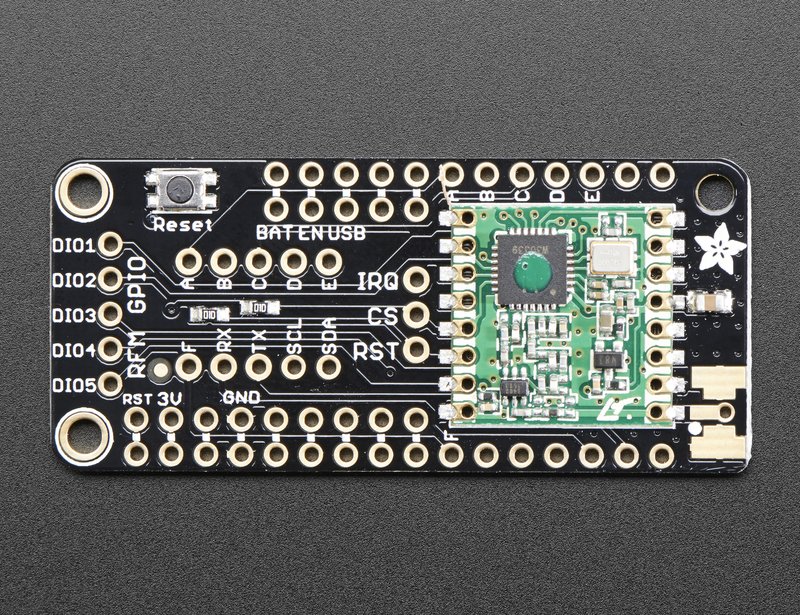

Hello,
I'm attempting to get the Adafruit RFM69 Radio Feather Wing to work with the Huzzah ESP8266 Feather. I'm trying to compile the receiver example code here:
I made the specified changes for the Huzzah's CS, IRQ, and RST pins and downloaded the RFM69 library. However, the compilation is failing with the message:

It compiles fine if I set the target board to Adafruit Feather 32u4.
Any help would be appreciated.

Bottom line, I got the code to compile simply by removing the 'RFM69_OTA.cpp' file from the folder containing the rest of the RFM69 library. No errors and the code now works. To me, that suggests two possibilities:
  • The library was updated AFTER the code in question was lasted tested with the ESP8266 micro-controller.
  • The code was NEVER tested with the ESP8266 micro-controller. I find that hard to believe since it contains comments referencing that processor.
This also raises one other question. Why was Arduino IDE attempting to compile the 'RFM69_OTA.cpp' file at all? Obviously, none of the functions it defines were being used by the sketch in question.
