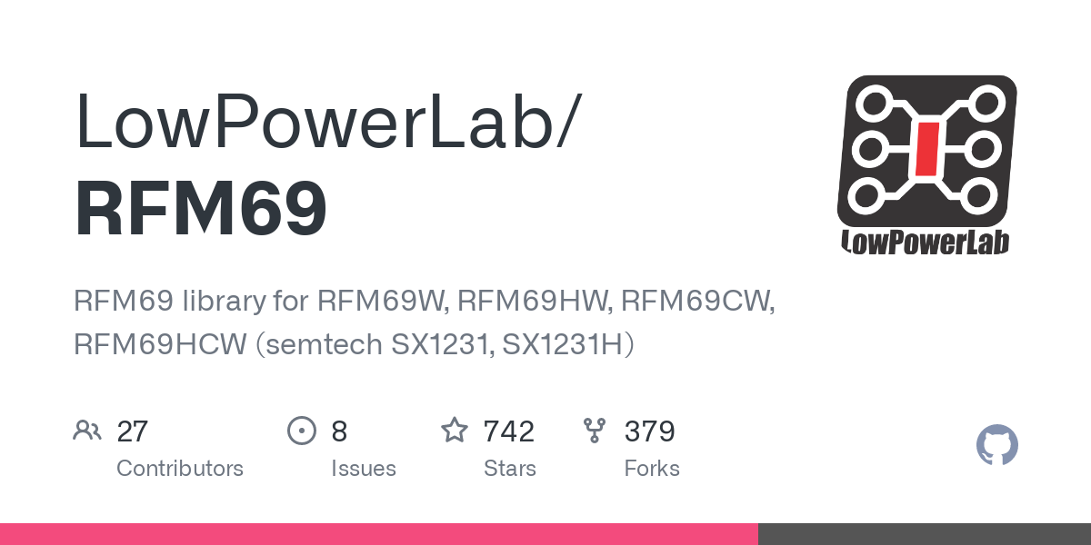

This is tha latest one I've noticed
also: just found https://github.com/aanon4/RFM69
use high power..; setHighPower();
