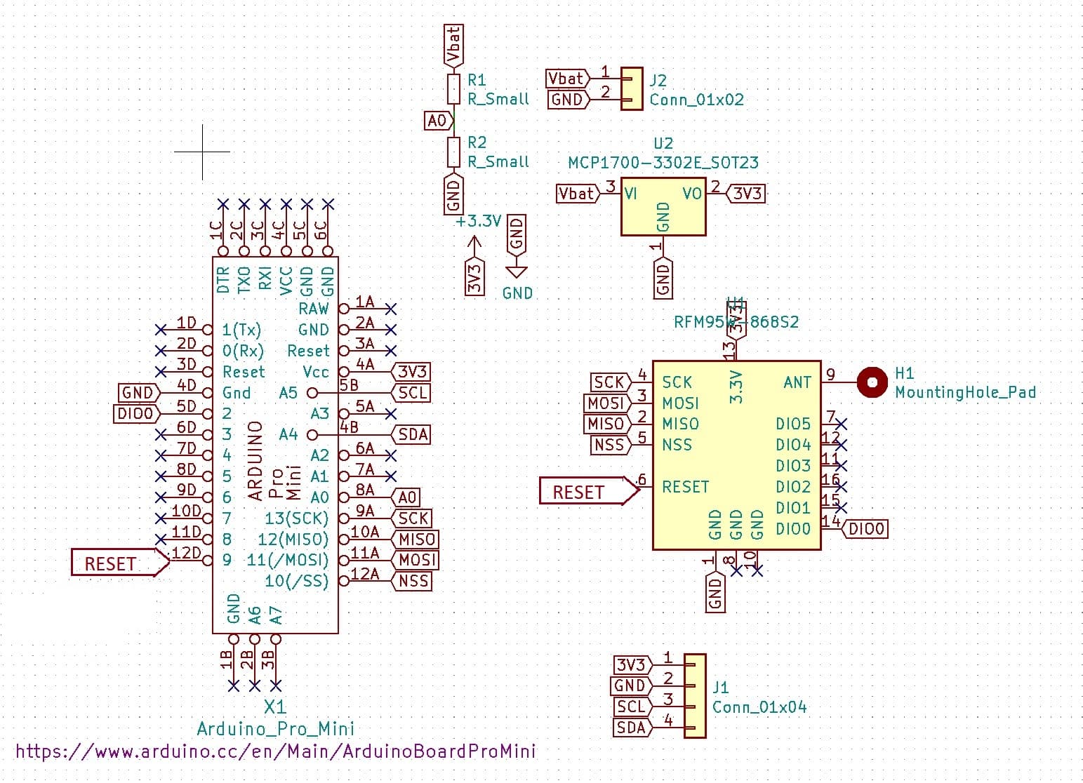

RFM95W transceiver module burning out at runtime
Do you think I should change the voltage regulator?
I have also attached the schematic that I have used (using MCP1702 instead of MCP1700):
The MCP1702 is also powering the INA219 sensor and the Arduino is switching to BC337 transistors (1K resistor between arduino pins and base of transistors) that are not connected to any load for now.
