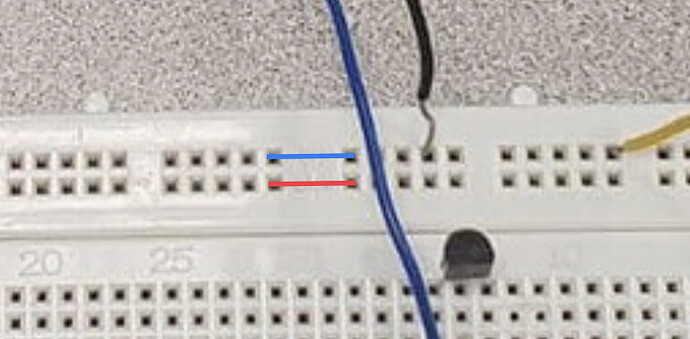

Hi Tom,
I quickly realized that mistake and fixed the wiring. Now the problem persists in that the LED Strip sometime works and sometimes does not when the values in the dashboard are changed. I tried to ensure all the connections are firm. Hope you could help me out!
We need to see your code.
Yes Tom, here is the code:

Hello, I wonder about your led strip. Do all of the leds light up the same and can't be different colors? I have an old rope claimed RGB but has red, green and blue leds on 1 wire each color and one ground, 12V.
The BJT is going to get hot with much current draw.
If you use a Logic Level (opens full at !2V) FET, you PWM brightness as field effect transistors need to be full closed or full open to not burn up where bipolar junction transistors get hot with current flow but make great "valves".
But worth a million of those is WS2811 12mm tree lights that fit 1/2" holes and have easy-hack wires between and every bulb in the chain can be set with a 24 bit color, 0-255 each of red, green, and blue, 16 million shades and every bulb has a color that can change faster than seeing.
As you mentioned, my RGB LED strip has inidividual R,G and B LEDs and one 12V pin. The LEDs can't light up in different colours, and if I want a combination, I will have to code for all 3.
And could I understand what you are trying to explain here? Forgive my lack of experience.
And finally, what should I do so that I can get my contraption to work?

The 2N3904 will not work for you application.
Your strip needs 1A per color (total 3A) and the 2N3904 can only handle 0.2A.
Use a ZTX1049A
Sry, I think you've done all these experiments but I am not finding it looking through the small window, so state the results you got, or get, when you…
get one regular LED to function. Leave the strip aside, attach or don't a single LED maybe with a transistor driver. One LED can run directly off the Arduino.
So…
The function onGreenValueChange() gets magically called and changes your variable, I accept that rather than look into it.
With no external circuitry on the Arduino. Does the value printed for the magic variable greenValue change reliably with the external activity meant to make it do?
Can you place a single LED and series current limiting resistor (for 5 volt operation) on the Arduino output pin (pin -> resistor -> LED -> ground)) and observe correct behaviour?
Can you get success with a 2N3904 using it to drive a single LED and series resistor (for 12 volt operation) and the external power supply?
---> Using the blink sketch, but replacing digitalWrite(thePin, HIGH) with analogWrite(thePin, 255) and similarly analogWrite(thePin, 0) instead of LOW does the LED blink? Wire the LED without the transistor, just a resistor to ground.
You can see my questions march you through tests that should all work. Tests independent of the large strip. Tests independent of the magic external control signal. Tests the transistor. Tests the PWM output. Tests the reception for changes to greenValue.
Divide and conquer. If these test don't work, no point in using the strip yet.
I would think the 2N3904 would burn out pretty soon. I can't explain the less than satisfactory but continues to work functioning that you describe.
If all the test work, then it looks like you do need a beefier transistor or switch to a MOSFET circuit as has been suggested.

Hi Alto,
Sorry for the late reply.
I conducted the tests you mentioned, and here are the results.
I have a IOT Cloud "thing" named greenValue, and I set it as an integer with a limit from 0 to 255. I attempted to see the greenValue through the serial monitor, and I came to see that despite what value I put the number in my IOT Dashboard, the serial monitor always displayed 0.
I attempted to do the blink code using the analogWrite function, with both the 2N3904 transistor and a KA7904 MOSFET. Both did not work, with the RGB LED staying stuck at a constant brightness despite the changes I make to it. I also tried to wire the LED directly to the pin, and yet there was no effect.
Here is my blink code.

Some boards have broken power rails.
Are you sure you have an RGB(W)LED? The devices in the spool looks like WS2812 of 30 per meter.
Writing 255 to the green pin should make it as bright as it gets.
But if you are trying to use as WS2812... those are digital, not analog! Those are ones you feed 5V, GND and a data pin that you need a library to handle the data timing.
My RGB leds have a bulb and 4 pins, WS28xx is modules. I like WS2811 Tree Lights because the modules have easy to hack wires in between the bulbs like 4 fingers wide insulated wires, not tiny pads to solder!

If you have a single regular LED and appropriate series limiting resistor, you could perform experiments you have not reported doing.
Please post a .ink to and better pictures of your LED strip. If we've been working on a smart LED strip, it's all been quite a waste of time.
Maybe a picture of the end of the strip would have some pin names we could know for sure you have a regular RGB LED strip, meant to be used in the manner you are attempting.

Hi Alto,
I retried my RGB LED with the same 2n3904 transistor, and it works now. A simple blink code generates the expected result. I came to realize I had many faulty transistors. The problem now is that the int greenValue remains at 0, as observed through the serial monitor, even though I am changing it from the dashboard.
I have ensured that my wifi has been set up properly for the cloud to work with. I am still confused as to why my changes from the dashboard are not syncing to my board. Here is my new code.
