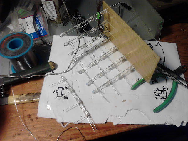

The transistor cube is coming along nicely. I have 16 spires built, and I have 20 transistors soldered and circuit wired up for them. im still trying to figure out the best way to assemble the spires onto the PCB. Im thinking that making 4 spires into 1 plane, then fit each plane onto the PCB. I'll get some pics up today.
Heres one image of the spires being assembled. I havnt soldered them together yet, but I think this is how I will do it.
This is an ugly picture of the transistors. I grouped them badly. It was to make it fit in a small space. After soldering them in like this, I realized I could use a little more space, put 4 transistors inline, and the wiring would have been a lot neater and tidier.

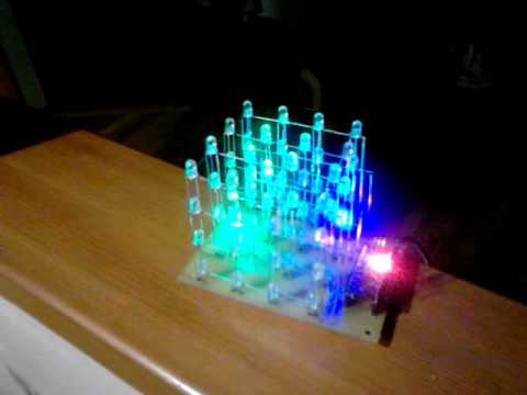

Ive finally gotten the transistor cube working. Heres a quick video
This circuit uses:
64 Common Cathode RGB LEDS
20 NPN transistors (2n2222, I used tiny sot23 package parts, but any 2222 should work)
20 Resistors (eight 270 ohm 2n2222 base resistors, 12 anode resistors (eight 100 ohm, four 150 ohm)
The cube layout uses lines instead of planes. Typical 4x4x4 cube construction uses 4 planes of 16 LEDs, this uses 16 lines of 4 LEDs, which brings the duty cycle down to 6.67% (from 25%), but it requires few parts, and doesnt require off-board power, since it only lights up a maximum of 12 LEDs(4 RGB LEDs) at a given time.
This specific cube was made using the LED leads and no additional stiff wire, It is also sized to fit a slightly smaller circuit board (this board is only 3" wide, so the LEDs are about 7/8" in apart, unlike the other cubes that are 1" spacing.
I think it looks horrible in the daylight, compared to the cubes with nice stiff wires, but when its dark, you dont notice so much.
This cube use 20 pins on the microcontroller, and on most arduinos, that doesnt leave any pins left for additional features, and assuming you are using 20ma LEDs you could draw upto 240ma at one time, which may be too much for 28 pin dip arduinos.

I could use some help fixing up this code to work right. The hardware tests fine with my other program, but I have been having no luck getting this one working right, and could use some help.
I've spent a bunch of time going over this code, and changing things many different ways.
I still havnt figured out how to make this program work with the transistor cube.
Most cubes are planar, but this cube is different. Its similar to the charliecube in that it treats the cube as 16 LEDs in a spires of 4 LEDs. Changing the program that runs 4 cycles of 16 cycles of LEDs, seems simple enough to convert to 4 cycles of 4 cycles of 4 RGB LEDs,
On my previous post I was trying to make the program load the 64 bits at a time, and it was making things crazy and complicated, so a couple days ago, I tried changing it back to 16 bits at a time, while lighting 16 spires/line of 4 LEDs, one spire/line at a time.
The way I was expecting the program to work is basically like this:
1 row pin and 1 level pin turn on a individual cathode for 4 RGB LEDs in a line (spire).
12 anode pins control the 4 RGB LEDs. To keep things simple, we are treating each RGB LED as a single color LED, and using 1 bit per LED
This code includes 3 versions of the anode pins that use a "1 << variableName" thing,
The program starts with the usual declaring variables, and setting up the pins, then starts a couple loops and has some while statements. The loops used to be 16 and 4, but I needed to change it to 4 and 4 with 12 anode writes instead of 1 anode write.
The original version has a pattern buffer index that points to one of 16 bits of data, and it increments until it completes its cycle, then advances a plane, and reads in and processes that 16 bits. It does this 4 times to complete 1 line of data (64 bits).
Im trying to make this program cycle 4 lines of 4 LEDs at a time, then increment the pattern buffer index 4 times, which should be the same a sequencing 16 LEDs on a plane (4 lines of 4 LED is the same as 16 LEDs in a 4x4 matrix)
I have found that if I comment out the pattern buffer index, I can get things to start to work, but never quite right. Sometimes it lights up many LEDs instead of one, It only seems to read the first 4 bits in a 16 bit segment though.
If I enable the pattern buffer indexing lines, the cube lights many leds on many levels, its really weird.
Heres the current not working quite right version. It only has a couple lines of data I just change the data with 1s and 0s to test that I can control each LED one or more at a time.
