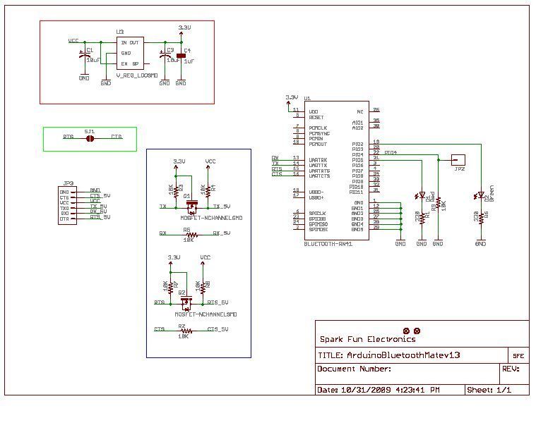

Here's the schematic off the datasheet. Could someone post a schematic of the minimum/simplest way to connect this to an Uno?
Just copy the schematic of the Bluetooth Mate Gold if you need level conversion, or run the Arduino at 3.3V
Trying to understand the schematic, and make the Rn41 work with the Uno.
In the schematic I've attached from Sparkfun:
The part I've highlighted in BL: Could that be replaced with the Logic Level Converter from SparkFun (http://www.sparkfun.com/products/8745)
The part highlighted in RD: Is that just a 3.3 volt power supply? So the Uno has a 3.3 v pin, I could use, correct?
This is starting to all look pretty easy.
...what is the part I've highlight in GR?
And lastly, There are 4 pins being connected, but I thought I'd just need Rx and Tx for a general purpose 'serial pipeline'? Do I need rts & cts?
SJ is solder jumper
You don't need RTS or CTS
The 3.3V pin on the Uno can be used instead of a dedicated power supply circuit (I think... Only if RN-41 use less than 50 mA), but any version before Uno has a baaaad 3.3V supply from the FTDI chip and I would never use it.

Thanks, to make sure I got the diode right, I drew up a quick schematic:

Your diagram looks right
The diode should ideally have a low voltage drop, I forgot to mention that, get a Schottky diode
Leave RTS and CTS unconnected

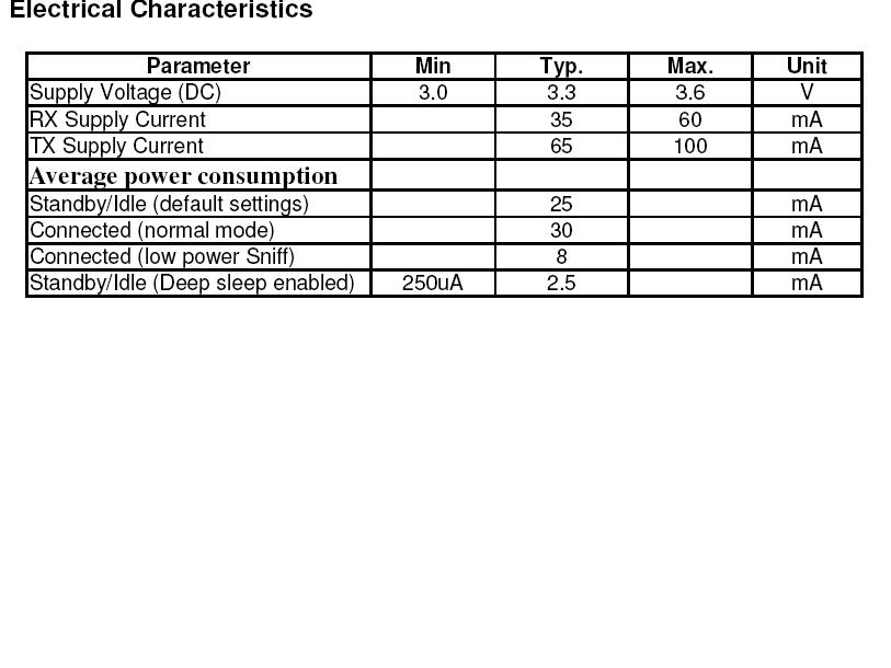

I actually don't know what the RX and TX supply current actually means, sorry.
The regulator that comes with USnooBie (see my signature below) is the TC1262 and can supply 500 mA worth of 3.3V
Anyone else know if you can use the Uno's 3.3 v to power the Rn-41; the specs (see my previous post) kinda say 2 different things...
