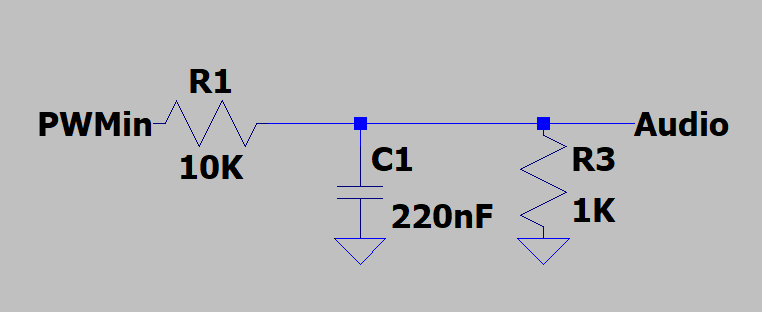

To play this on a sound system, a voltage divider and low pass filter on pin 11 is needed, with a rolloff of about 4 kHz.
This is what I used, for a capacitive coupled audio amp:
