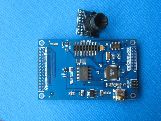

Robot Camera  With  2.8" TFT
We make this Robot Camera Kits With 2.8" 65K touch TFT Display (Arduino Compatible)
It includes camera, screen and control board. Control board is placed on the back of the screen. Camera sensor generates image data which is then processed real-timely by control board and displayed on the screen.
The Screen is 2.8 " and 65K color, supporting touch TFT function.
Camera is 30W Pixel OV7670 camera, which can supuly distinct image for normal use.
Control board is integrated with Atmega 32. So it is compatible with Arduino, which makes it possible to communicate with Arduino easily.
Many interfaces on the control board are still reliable, including 4-channel ADC, 1 channel USART, ISP port and 2 channel PWM, which makes function development much easier. :slight_smile:
5V power is supplied to the control board via USB port, without any special requirement for power module.
OV7670 screen's power supply is 2.8 ~ 3.0V, which is TTL level for most of MCU.
TD/SD card can be connected to SPI port, which makes image storage possible.
Camera interface is plug-in mode. It is very easy to connect or disconnect with control board. Control board and camera can be used separately. :slight_smile:

I'm wondering how you are going to make any headway into a VGA camera's image which is about 1MB native and about 20-30k as a jpeg with an 8 bit processor with 2kB of ram. The arduino will probably take 10 minutes to establish if a frame has any blue in it......
It's pretty obvious that many people here have a very limited perception of how seriously low powered an Atmega microcontroller actually is.
Hint : your computer has a million times more memory and storage than a Duemilanove. (literally)
I think this display and touch screen have a lot of potential but I would have thought that you want a mega-type chip at least (1280?). Yes, the ATMega chips are not very powerful but a lot has been done with them. I do however doubt how fast this camera, screen module thingy will be.
If it is cheap then I might pick one up though.

I never had any doubts that it could display the camera picture on the screen, but how exactly does this involve an Arduino ?
Well I was querying the fact that it would do all that while being controlled by an ATMega32 (yes 32).
I think that is pretty impressive.
The arduino would just control the taking of a picture and whatever else you want it to do as far as I understand it. The onboard ATMega32 controls the camera and screen (and storing of pictures etc)
Well, you can see there are still many vacant pins on the control board. You can expand the function to work with Arduino. :slight_smile:
