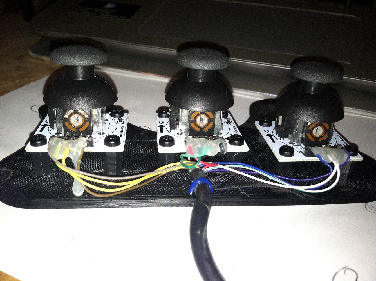

The joysticks commonly used with an Arduino have two potentiometers (aka pots). Pots have three connections. One connection is set to 5V, on connection is set to ground. The middle connection known as the wiper connected to one of the Arduino's analog inputs.
Here are some joysticks gyrojeremy used in his robot arm (first link I gave earlier).
This joystick has three pots.
The third pot is in the knob.
