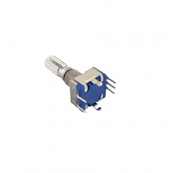

I built a project that has a rotary encoder with push button in it but didn't work well so I tried THIS example code.
It keeps outputting nonstop unless I give the rotary a notch in either direction but it will start outputting crazy if it's moved.
I'm using one of those without board so no VIN.
Any thoughts?

First of all, use Physical 10K pullups and add a 10nF capacitor (to GND) on all 3 pins.
Then show us your code.
what host microcontroller are you using?
show a schematic of wiring?
try using the internal pullup resistors
  pinMode(CLK, INPUT_PULLUP);
  pinMode(DT, INPUT_PULLUP);
  pinMode(SW, INPUT_PULLUP);
It sounds like contact bounce, give us a schematic as requested by @horace and the code as requested by @mancera1979.
This is the library I used
I think the code is messy since I had to edit it a lot.
If internal pullup doesn't work I'll use external.
But I specifically used a example code that didn't use external and it kept dancing around.
It's an Uno.
Wiring is
Main Pin --> D3
Sec Pin --> D4
BTN Pin --> D5
All with 100nF cap to GND
if the encoder code is using interrupts the interrupt enabled pins on the UNO are 2 and 3

The encoder in the example from post #1 is soldered onto a board that already includes the resistors and handles debounce with a simple 1 ms delay.
I seem to remember using the td_libs_Encoder library on a UNO and it worked OK
But... is the common pin connected to GND? Then there's still the debounce issue (post #4), and finally the correct edge detection (post #3 — one encoder step involves reading four edges). And interrupts are not a magical solution — in fact, they can introduce additional concurrency issues with other parts of the code.

I tested it again with example code from post #12 and button doesn't work and it prints positions erratically mostly up and can't go down without cap, and just one position up and one position down with cap regardless of the direction of the nob.

You may just have a bad encoder.
Do you have a DMM to do some testing?
