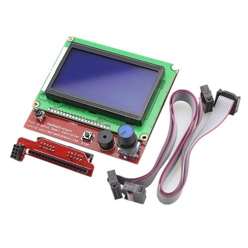

I am using Arduino Mega + ramps 1.4 (shield) + RepRapDiscount controller( ST7920 128X64 );
Im trying to get the rotary encoder to work, ן uploaded the example file "Menu" from the u8glib library and changes the pins of the LCD to be correct, but the code it mean to be for buttons and not for rotary encoder

i think that the pins of the encoder should be those:
#define BTN_EN1            31
#define BTN_EN2            33
#define BTN_ENC            35
Help, pls
thanks!
#define BTN_EN1 31
#define BTN_EN2 33
#define BTN_ENC 35
That is what I have for those pins and they work on my Mega with RepRapDiscount display.

Where did you get that code? It looks like it was written for one of those LCD shields with the 4 o5 5 buttons, not a rotary encoder.
yes, that id exactly my point
i got the code from the library examples of the "U8Glib".
im using this one:
i want to modify that code for the rotary,
thanks!

The LiquidCrystal library will not work with that display.
Ok thanks!
I managed to play with some code i wrote / got inspired from libraries and internet. i want to make a menu of 3 case [A,B,C] and use the encoder to scroll between those 3 titles.
so i used 3 pins to read the encoder (right,left,push) the code for encoder from u8glib to count to rotates of the encoder.
but, i works not good. i can rotate the encoder and nothing happens, the scrolling jumps between cases and it works sometimes really slowly

The only input you're looking at in the encoder section is BTN_EN2. If BTN_EN2 is your clock signal then BTN_EN1 is the data signal. Substitute
    if (digitalRead(BTN_EN1) == LOW) {
      encoderPos++;
      encoderPos--;
thanks you!!
