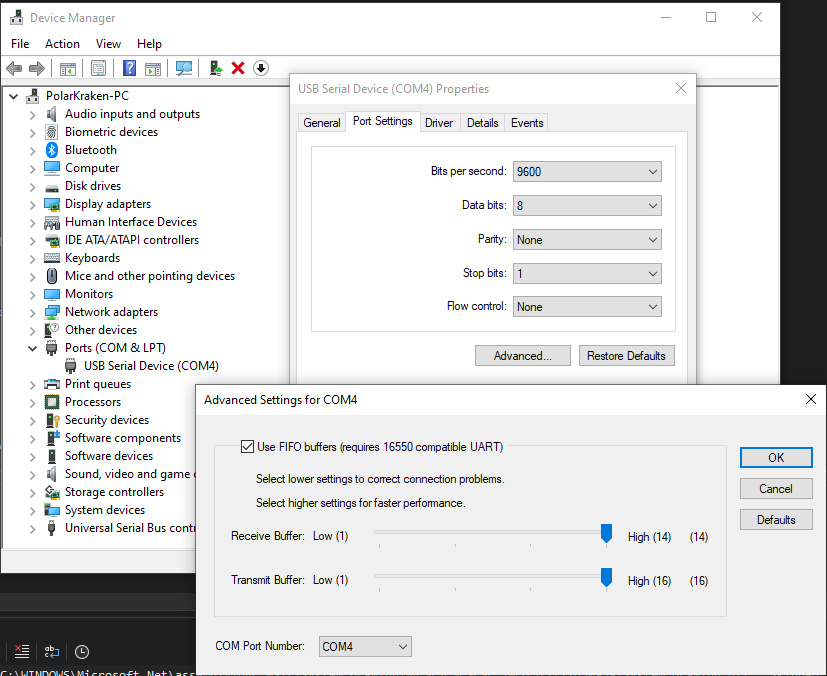

I have turned FIFO buffers on and off in the Device Manager.
My RP 2040 is on COM4.

I have stepped through the code in VS by breakpoint and the interesting part is the first time the write appears to go through, except it has no effect on the RP 2040 Connect, the LED never changes.
The second time either button is pressed the running forms app hangs, like its waiting for a response.
If I use:
sp.WriteTimeout = 5000;
I get an error message after 5 seconds:
"An unhandled exception of type 'System.IO.IOException' occurred in System.dll
The semaphore timeout period has expired."
This happens in both 2017 and 2022 regardless of any settings I change. I have tried it with a number of simple tutorials to the same result.

Well, here's the fix:
sp.DtrEnable = true;
Thread.Sleep(150);
