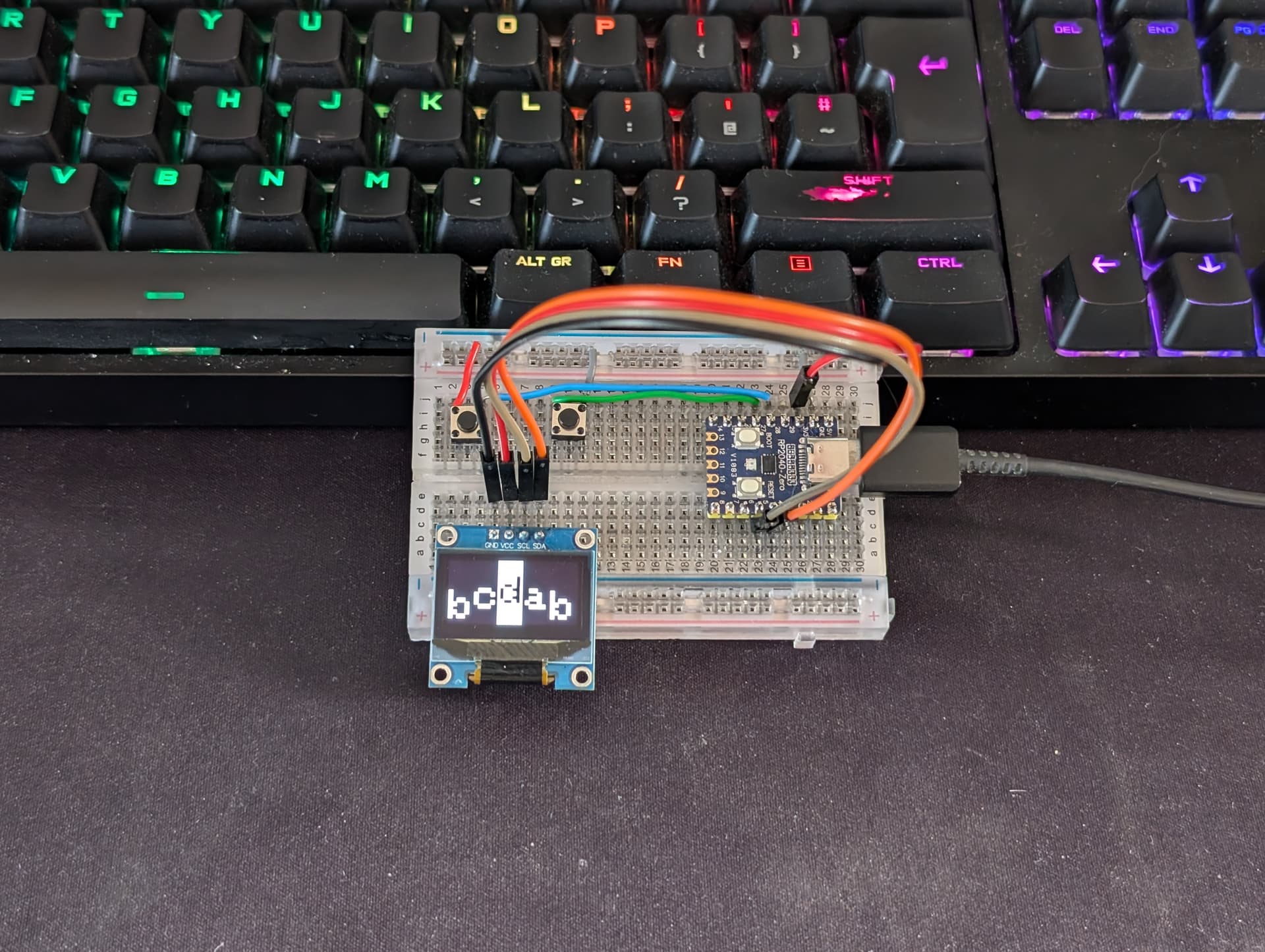

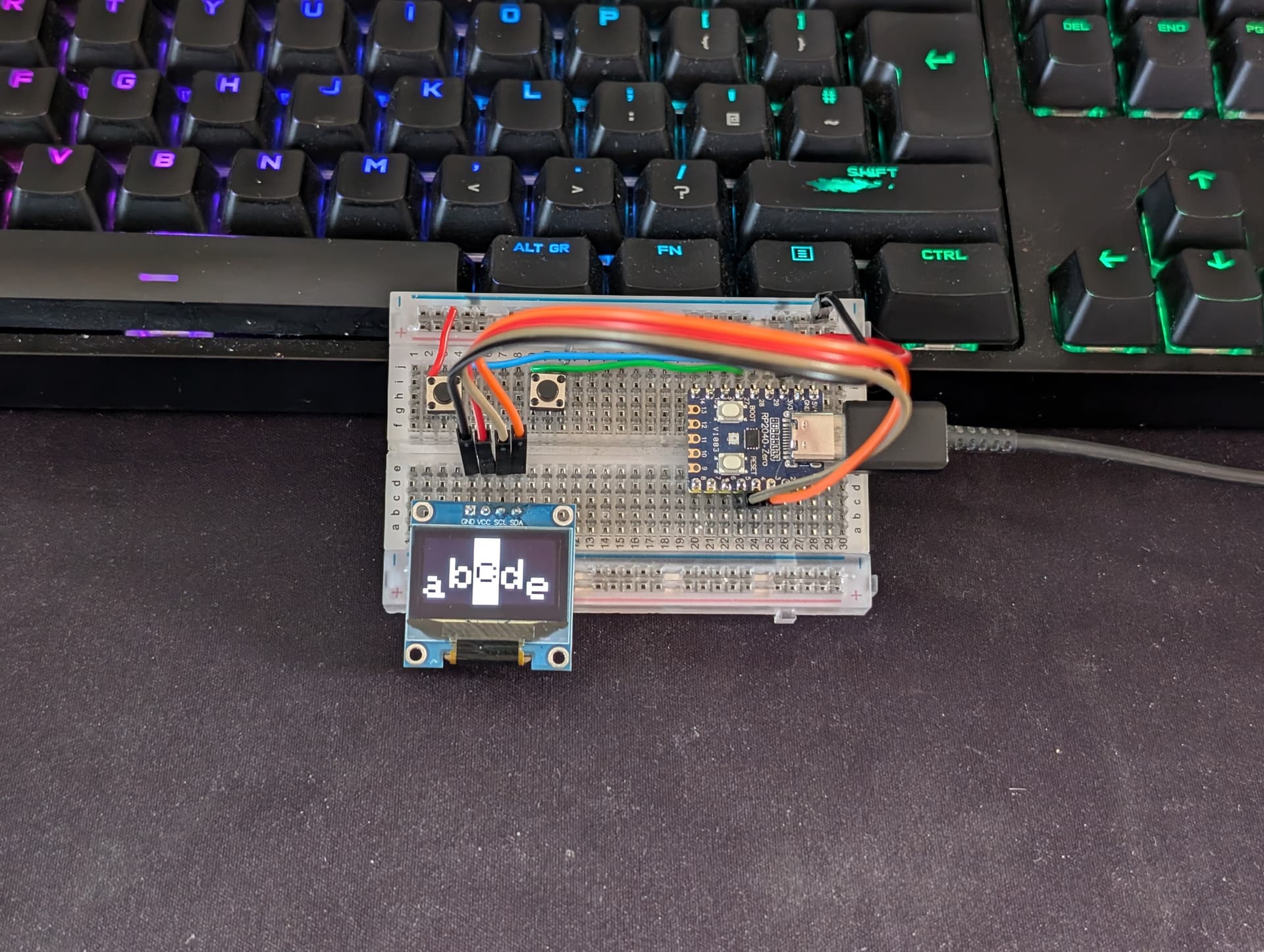

RP2040 - Wiping through a char variable, duplicated characters appear
Using a WaveShare RP2040 Zero, two buttons, and an SSD1306 128x64 OLED.
I'm "wiping" over "const char Characters", it has uppercase, lowercase, and numbers.
if I scroll left, I see the first four character from Characters are repeated. But if I scroll all the way right to the point it wraps around or all the way left, the duplicated characters do not appear.
I'm super new to C++ and simply cannot see the issue.

Wiping. "moving" the variable under the 5 text positions.
Here's a video of how the "wiping" looks - LINK TO GOOGLE DRIVE
The leftleftchar int bit was a nooby way of tracking all my variables. its a readability thing for just me.
