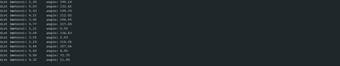

Hello Everyone I am using RpLidar A1M8 from SlamTec and I followed the tutorial from "https://www.instructables.com/How-to-Use-the-RPLIDAR-360-Laser-Scanner-With-Ardu/" to set up my arudino and lidar. From this video the value of the angle and distance are consistent and sensical. However mine returns arbitrary values here is a screenshot:
I have tried multiple different baudrates and changing wires but to no avail.
Here is my code running on arduino:

Sorry your screen shot is not readable. Consider reading the forum guidelines they will help.
Here is another screenshot
Cut and paste text, not screenshots. Consider reading the forum guidelines they will help.
Test the lidar by itself, with simple example code, and make sure it is working properly before adding other code. Arduino device libraries usually include example code for testing.
I used the following sample code:

I am getting absurd angle values : 511.73
255.98
497.52
254.98
383.98
497.98
503.92
510.23
Have you contacted SlamTec for support? The device is hardly ever mentioned on this forum, so it is unlikely that any of the regulars have hands on experience with it.
Absurd angles are reported as normal here:
They suggest subtracting 360.
The randomness in angles might be from slow sampling due to low baud rates, and delays causing many of the 8000 samples/period to be skipped as the turntable spins.
I'd modify the sample code to increase the baud rate and show the times:

Resetting
SLAMTEC Lidar health status : 0
Motor Speed Control Support: None
Avaiable Scan Modes:
Mode ID: 0, Mode Name: Standard, uS Per Sample: 508.00, Max Distance: 12.00, Answer Type: 0x81
Mode ID: 1, Mode Name: Express, uS Per Sample: 254.00, Max Distance: 12.00, Answer Type: 0x82
Mode ID: 2, Mode Name: Boost, uS Per Sample: 127.00, Max Distance: 12.00, Answer Type: 0x84
Mode ID: 3, Mode Name: Sensitivity, uS Per Sample: 127.00, Max Distance: 12.00, Answer Type: 0x84
Mode ID: 4, Mode Name: Stability, uS Per Sample: 201.00, Max Distance: 12.00, Answer Type: 0x84
Here is the performance data measured by my code:
Scan Mode: Standard
Scans Rate: 7.6 Scans/Second
Sample Period: 511.9 us
Sample Rate: 1954 Samples/Second
Scan Mode: Express
Scans Rate: 7.3 Scans/Second
Sample Period: 267.5 us
Sample Rate: 3738 Samples/Second
Scan Mode: Boost
Sample Period: 127.9 us
Sample Rate: 7818 Samples/Second
Scan Mode: Sensitivity
Sample Rate: 7817 Samples/Second
Scan Mode: Stability
Sample Period: 201.0 us
Sample Rate: 4975 Samples/Second
The values are pretty close to what is claimed. The Scan Rate is the same for all modes. The value of 7.6 complete scans per second corresponds to 456 RPM which seems plausible.
