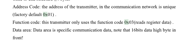

RS485 anemometer connected to an ESP32
Ok, a bad contact. Now I receive:

Is this what we expected?
I don't think so.
Where you can see your sensor? In HA?
sending part looks correct:
[17:59:38][V][modbus_controller:047]: Sending next modbus command to device 1 register 0x00 count 1
[17:59:38][V][modbus:199]: Modbus write: 01.03.00.00.00.01.84.0A (8)
In HA I can see "wind speed" but it's unknown. I'm seeing the logs through https://web.esphome.io/
did you add that in yaml where your other sensors are?

Maybe related to this?
Maybe it's not reading correctly?
I don't know what you mean.
Slave is 0x01.
This is correct: 17:59:38][V][modbus:199]: Modbus write: 01.03.00.00.00.01.84.0A (8)
Ok, just was a bad thought, just thought it was not reading the values correctly, as the sensor is "unknown" in HA
Esphome is sending correctly.
but I don't understand those 7 received bytes...
