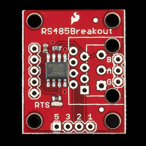

I'm graphically limited, but the connections are simple to understand. I've described it here:
The module I'm using has an input called RTS, which is connected to both DE & !RE. Therefore, for the transmitter RTS=1 and for the receier RTS=0.

Just to clarify, you have removed the 120R resistors from both of the Sparkfun boards?

RS-485 is a 5v protocol normally, maybe the board you have can run on 3.3v but for that i need a link to the exact board.

Well the obvious is to set one breakout board up as a driver, set the logic input 'HIGH' and measure the voltage between A & B, and then repeat this for a logic 'LOW'
It can receive 3-5V, I chose 3.3V so it would correspond to the arduino's GPIO.
Link: https://www.sparkfun.com/products/10124

You should see a +ve voltage between A & B with the pin Sparkfun call RX-I in one logic state. When you change the logic state of the RX-I pin you should see a similar but -ve voltage.
The SP3485 datasheet suggests that the voltage should be in excess of +2V or -2V depending on the state of the data in pin.

Sorry, I missed that bit out - RTS should be tied HIGH to enable the line driver.
In case it helps, I have a MAX3485 breakout board here. It has a 120R across A & B, and it has a 4K7 pulldown from B to GND, and a 4K7 pullup from A to 3.3V.
I have a DMM with the +ve lead connected to A and the -ve lead connected to B
When powered from 3.3V, and the line driver enabled, connecting DI (Sparkfun call this RX-I and it's the second pin down on the 5-pin conn on the left in the picture in post #26) to GND the DMM shows -1.38V and if I then connect DI to 3.3V, the DMM shows 1.41V.
That shows that the line driver is working in TX mode.
When I disable the line driver (i.e. GND onto RTS) and connect the DMM between GND and RO (what Sparkfun calls TX-O), and connect A & B as follows:
B to GND & A to 3.3V - DMM reads 3.29V
B to 3.3V & A to GND - DMM reads 0V
That shows that the line driver is working in RX mode.
If you see similar results with your Sparkfun boards, then at least we know they are working.
Following this experiment, I get results with the values of +-2.5V, exactly in the cases that you've described.
Ditto, I read 3.26V.
So my Sparkfun boards are working as expected.

The next step I would take is to connect the 2 boards together using the A, B and GND signals. I'd then set one with RTS high and the other RTS low. I'd then see if I could send a simple 1 and 0 over the RS485 link by connecting the pin on the TX side to either 3.3V or GND.
That should simply check your RS485 link is working.
