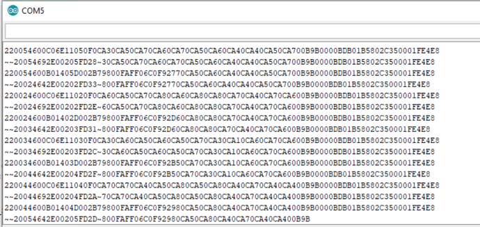

This is being done on a Arduino MEGA.
I've attached 2 "serial" files showing the output I'm getting from tapping in to the wire.
I suspect that the data I'm seeing is just coming from the battery to the invertor, but the data I require is only available from the inverter.

Ok, so I've got my "RS485 forwarder" working and the battery and inverter appear to be working normally. It took a while to get it working so that neither the battery or the inverter would know the data had changed, but it's working great now.
Attachment1: RS485_Forwarder.ino - code for forwarding
Attachment2: Serial1_Battery.txt - data being received from the inverter in HEX format
Attachment3: Serial2_Inverter.txt - data being received from the battery in HEX format
The code basically forward anything received on Serial1 to Serial2 and vice versa.
The question is now, how do I construct a message to send to the inverter to get the data back in the range 0x0200 to 0x0245 as referenced in the Inverter manual I attached in my original post (starts at page 9)?
I have checked the data coming from the inverter (as attached - Serial2) by converting them in to Integers (8 bit) and Words (16 bit) and they do not correspond to any data I'm expecting so I believe the data I'm getting is unrelated to the information I want.

One line of Serial1_Battery.txt is 39 bytes, so this cannot be bytes encoded in hex. Is it possible that the D at the end should be a 0D?
The data doesn't look like Modbus. Are you sure that the devices talk Modbus?
The data is in ASCII:
~20054642E00205FD2D
It might be Modbus ASCII but definitely not Modbus RTU.

No, I'm not. I can only go on the SOFARSOLAR document which states ModBus RTU and it talks directly to the battery so I can only assume that does the same.
I'll give the code a check over to ensure I'm getting 2 digits for each byte received as it doesn't look like that's happening. I've had a quick look and I can't see any hex pairs that start with 0 so maybe that's the issue.
i think I've fixed the issue and attached samples of the new output.
Does that look like the data you're expecting?
