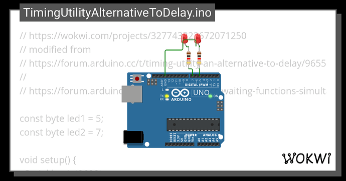

I looked at that.
There were some issues with scoping and keeping the multiple timer1s coordinated with timer2.
Here's some modified code using code tags:
// https://wokwi.com/projects/327743322672071250
// modified from
// https://forum.arduino.cc/t/timing-utility-an-alternative-to-delay/965542
// https://forum.arduino.cc/t/running-multiple-waiting-functions-simultanously/975765/91

Testing in:
