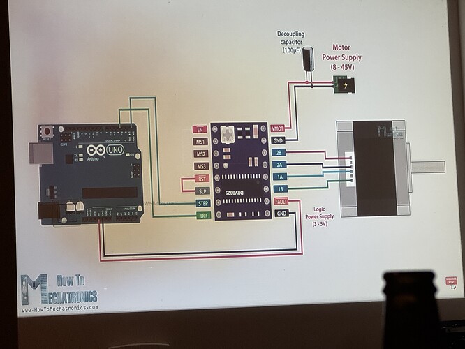

Please post a complete circuit diagram. Hand drawn is fine, as long as all pins and connections are clearly identified.

I just followed this online tutorial by “How to Mechatronics” and connected the step pin to pin 0 on the arduino and dir pin to pin 3.
The wiring diagram is wrong in two places.
/FAULT should NOT be connected to 5V, but /RST and /SLP should be.
Follow Pololu's wiring instructions.
Apparently this is an alternative wiring diagram according to the link you provided
Thanks, I wasn't aware of that alternative. Not the problem, then.
