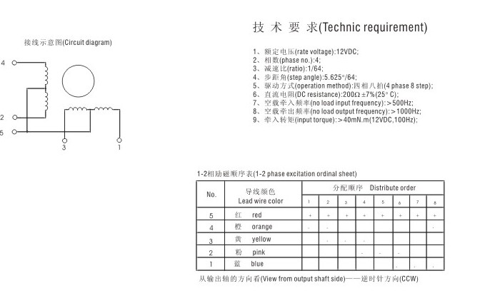

Here’s the draw of the stepper motor:
Here’s my CKT:

Well, it’s actually similar.
Here’s the internal windings of the MP2423.
Here’s the internal windings of the 28BYJ-48.
And, at the end I got to the solution.
I can just run the 12V stepper motor with the ULN2003 driver breakout board and external power source.
