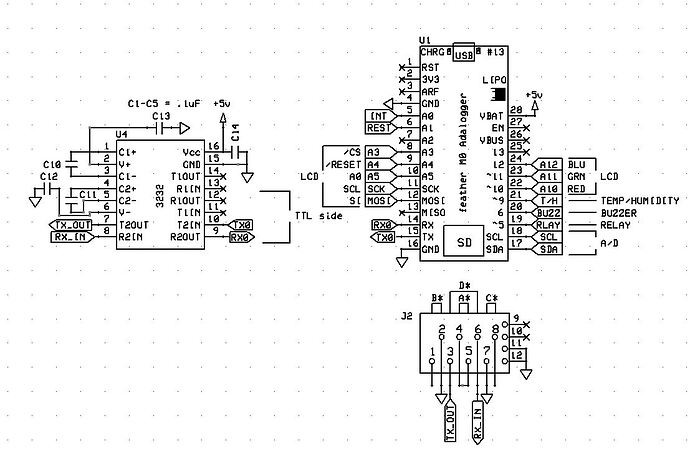

I am having an issue with a SAMD21 module from Adafruit with the serial port. I am using the built in TX/RX hardware port and I can see all my data in the serial monitor. However I have the TX/RX pins connected to a MAX3232 driver IC. I am not able to see ANY data on the physical TX pin.
I then tried another Module with no MAX3232 chip and I still cannot see any data
Below is the sample I am using. I even tried to use Serial.Write, and like before it shows up in the serial monitor but there is no data on the actual TX pin. I am using 9600 baud, and I have set the scope to 100uS sweep time. Im thinking it uses the USB UART, but how do I set this to transmit directly out of the Physical TX pin?

Attached is my setup, any help is appreciated.

Not familiar with SAM boards. But do SAM boards not use native USB instead of TX/RX when communicating over the USB connector?
Which board do you have exactly?
Use Serial1 for the UART Tx/Rx. Serial is the USB console serial port.
Thanks you for the Serial 1 information, it works!! I am using the Adafruit M0 Adalogger module.
I could not see the forest through the trees!!!
