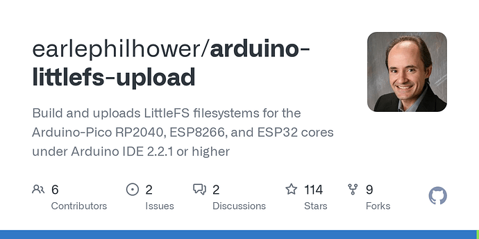

As for a feature of just copying a summary of the menu settings to the clipboard to document the settings only for human consumption, Arduino will not allocate resources to adding this feature (because we would instead use those resources to implement the more impactful auto-configure feature), but it would be possible for you (or any other community member) to create an extension that adds the capability to Arduino IDE.
Arduino IDE 2.x is built on the Eclipse Theia IDE framework, which supports VS Code extensions.
Arduino IDE 2.x extensions definitely have access to the board, custom board options, and port selection data via this extension (which is built-in to the Arduino IDE 2.x installation):
Unfortunately the Arduino IDE developers never got around to producing formal documentation about using that data, but you can see some examples of existing Arduino IDE 2.x extensions that use it here:
https://github.com/dankeboy36/esp-exception-decoder\
It also might be possible that extensions have access to data about menu settings directly from Arduino IDE. I don't have experience writing VS Code extensions so I can't say exactly what capabilities are available (though if you look at what has been done in the thousands of existing VS Code extensions, it is quite a lot!) but there is a lot of information available about writing extensions. If you are researching the subject, just keep in mind that the general VS Code extension framework is not specific to Arduino IDE, so don't "poison" your search by including "arduino" as a keyword. It is only the "vscode-arduino-api" extension's API that is Arduino IDE-specific.
