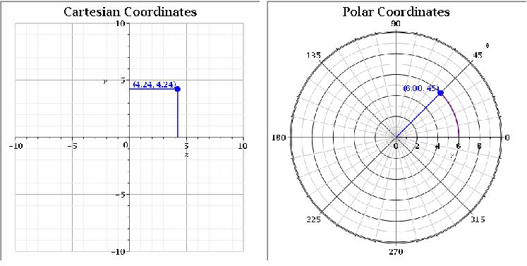

I know I have not stated my situation properly so let me try again.
On a simple 3D printer there are 3 axis X,Y and Z.
Once you identify HOME and the number of motor steps to move a given distance, it is easy to output to your printer a command to move (100 motor steps = 10mm direction movement)
My situation is different.
My movement is not in a straight line for one axis but rather a rotational movement. The other axis is relative to that rotation.
I need help in developing code to translate Cartesian vs. Polar Coordinates to achieve the same movement.
The attached photo shows my layout
To translate Cartesian to Polar coordinates:

Radius = 5.996 Angle = 0.79 radians or 45.00 degrees
Polar and Cartesian coordinates
