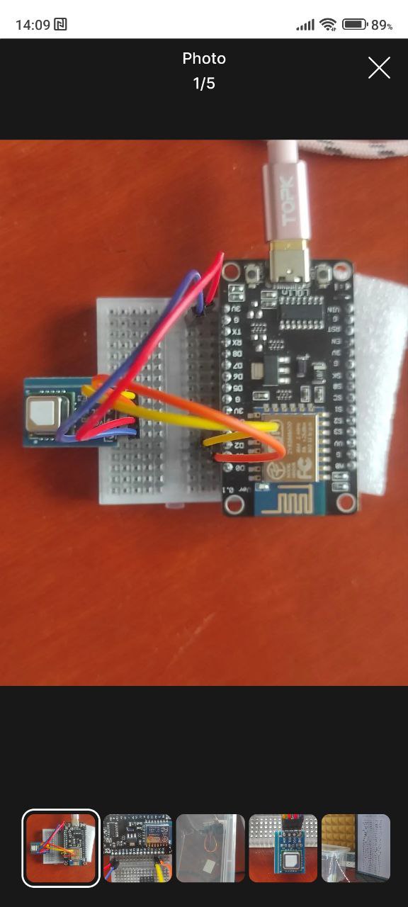

i have two SCD41 from AliExpress, probably used before, idk.
Both have absolutely the same behavior. Repeatability is +-40 even in perfectly stable (inside box) conditions.
I did forcefully calibrate them, reboot, set the altitude etc. Tried different measurement command - result is the same. I am using official lib with ESP8266.
is it poor quality sensor or am i doing smth wrong?

Anyway in your serial monitor image there is not that much fluctuation.
Also, try with another power source.
Thank you for suggestions! i tried both pc power end external - same...

So, at first i gotta say that both sensors is working...
The short answer is - i use "Periodic Measurement" instead of "Single Shot Measurement".
The long answer:
First of all, i tried all three Measurement at the beginning and result was the same... Or maybe in a rush i didn't wait few minutes for measurements to settle down a bit, i don't know...
Another thought that i have - initially i used "Periodic Measurement", than i tried, "ECO Periodic Measurement", then switched to "Single Shot Measurement"... And after i tried "Forced Recalibration" function...
After that i never tried to switch back to "Periodic Measurement" till today...
So my though is that it never worked correctly with Single Shot, but Recalibration fixed "Periodic Measurement"...
update "low_power_periodic_measurement" also working correctly...
