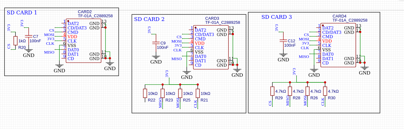

Schematic for SD_Card with Esp32
Which Circuit is Best for SD_Card with ESP32
I have 3 circuits
My understanding is that all four SPI lines are push/pull, and therefore do not need pullup resistors, and would not benefit from them.
IF you are not using any purchased SD module, then my opinion is the first schematic.
But it does not need the pull-up resistor.
no i am not purchasing module i am making my own PCB . So you are saying it does not need Pull-up resistors ,are you referring to CS?
Yes that is what he is saying.
I use 10K pullups, also on CS. Don't know if that is strictly required, but that was what was on the module i used before and i copied that. That works.
SD card 1.
Yes.
