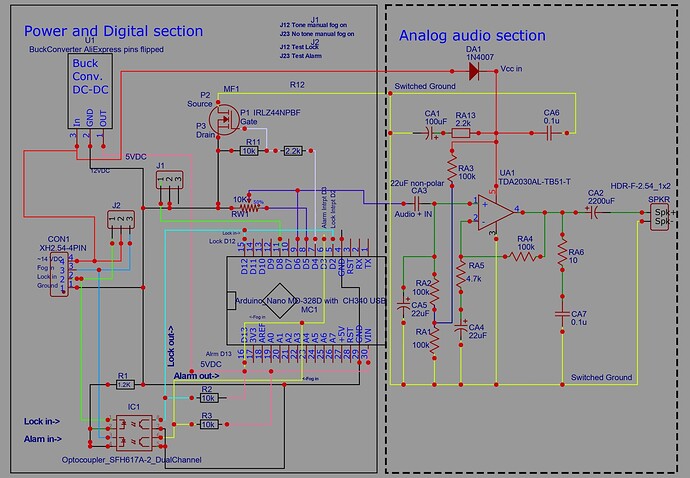

Schematic Review Please?
Hi Tom;
Interrupts are being used to wake up the Nano. This is in a weekend fun car and parasitic draw on the battery is a problem. After 10 minutes of inactivity the Nano goes to sleep.
I took your advice and there is only one (1) diode left in the circuit and it is being used for polarity protection. Here is the new schm.
Schematic_Car Alarm V5 with audio amp copy_2022-09-13.pdf (222.8 KB)
Schematic:

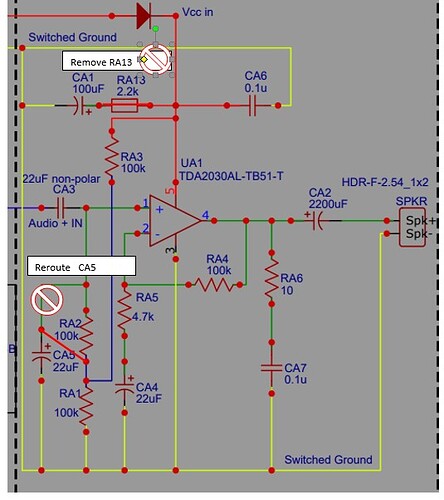

I see a number of things I don't understand, however the most obvious is C3 and C5. You have a capacitive divider. I think C5 should be across R1 only.
U1 gain seems odd, it's 1 at DC and goes to ~20 for AC (didn't calc the freq). The output of the the micro is 0 to 5V. It seems like someone copied a ref design which would likely be for a 1V input. You will likely saturate the output of U1 (i.e. drive it so hard the output goes to max).
Why the DC:DC converter. U1 can accept up to 22 volts so why not go right to +12 then make the DC:DC output 5V (or maybe use an linear regulator.
Two more....
Why do you need the amplifier at all? Since you are driving it with a a slightly filtered square wave anyway.
One general comment. It looks like you are copying an existing design, that's fine. However I don't see any input protection from RF and Voltage spikes. Automotive +12 is very electrically dirty. By specification, the +12 can go as high as 50V and will most definitely go to 16.4V

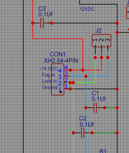

Fog in and Lock in have no protection for voltage spikes which can go from a few hundred to 1500V (for a very short period of time).
Thanks for the input John;
Last first:
I now have optocouplers on Lock and Alarm inputs, per another comment received. That should take care of the spikes and also eliminated the need for the voltage dividers to lower the voltage to the Arduino inputs. This eliminated several resistors and diodes.
The alarm sits under the hood and the theft alarm is just loud enough with the amp I am using. The lock tone is rather obnoxious at full vol, therefore the vol pot.
Latest rev is using a buck convertor +12 or whatever the car is generating, in and 5v out. I am using the buck to power the Arduino (cleaner power) and as the pullup voltage on the opto outputs. With the optos I can use pull down on all of the inputs. I understand the the A like to be pulled down rather than up.
This is a copy of a standard design for the amp chip. I'll double check my schm . Analog is not my thing at all.
Here is the latest schematic. All of the audio amp is now on the right and power/digital on the left of the board.
Schematic_Car Alarm V5_2022-09-14.pdf (213.2 KB)
Thanks for the time and effort!

I reviewed the audio amp section of the schematic and found 2 errors.
Thanks, you have a keen eye!

The spikes will still come through, you should put a 0.1µF cap at each input to ground and +12 (should be very close to where the wires come in to your enclosure).
A typical audio output of a preamplifier would be around 1V rms. You might want to try it before you commit to a PCB.

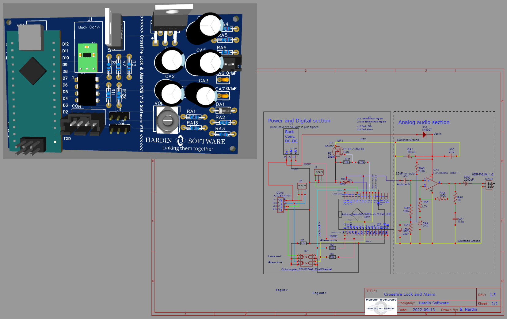

Resistors are cheap. Consider you will likely not be building 1000's of units. And if that is your goal I will guarantee you will be changing the PCB design before you get to that point. This has nothing to do with you personally, It's just how these things go (I've done this many many times).
So add additional capacitors for filtering and input protection. If you find you don't need them you can always leave them off the board.
Thanks for the reply. I will investigate
Have you breadboarded your project to test the prototype?
If not then do that before doing anything about a PCB.
I have a wired proto working in the car now.
