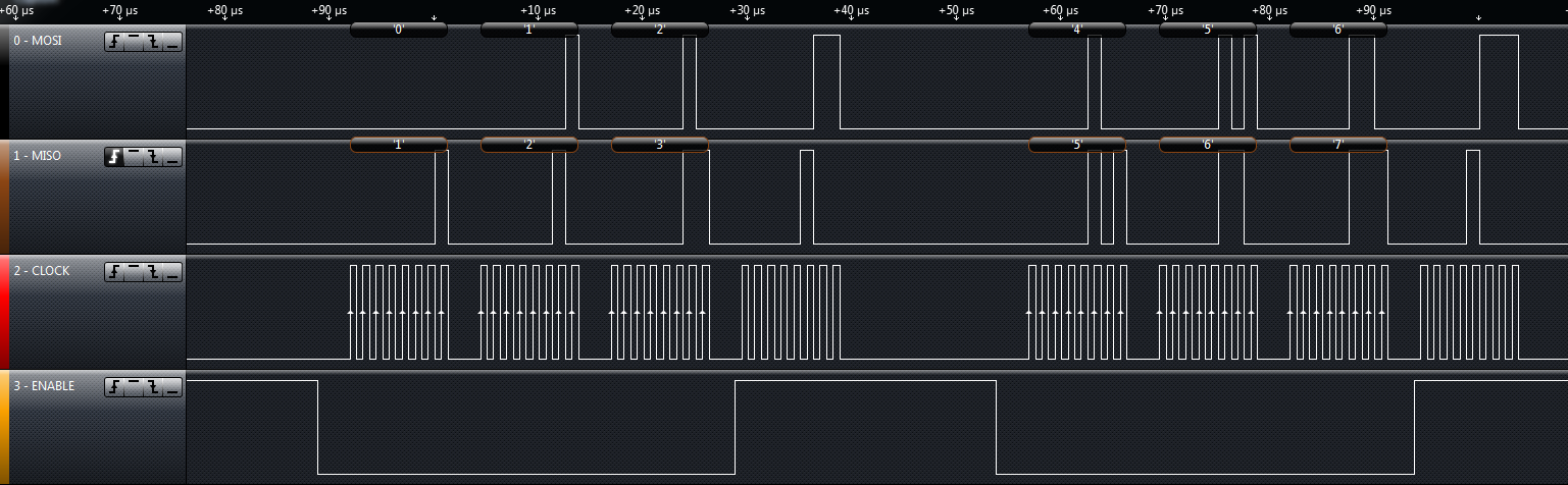

My logic analyzer has analog reading on every digital channel. It's not as cheap as my digital only analyzer but we had some money for it. Very nice for students to see TTL I2C SPI communication on it with bits converted into numbers or characters.
I have the cheap, older 'Logic 16' from Saleae.
Very useful to see the decoded values for: Serial, SPI, I2C and more, using their included software.
Examples:
http://support.saleae.com/hc/en-us/sections/201990583-Supported-Protocols
CAN:
Serial:
I2C
SPI
