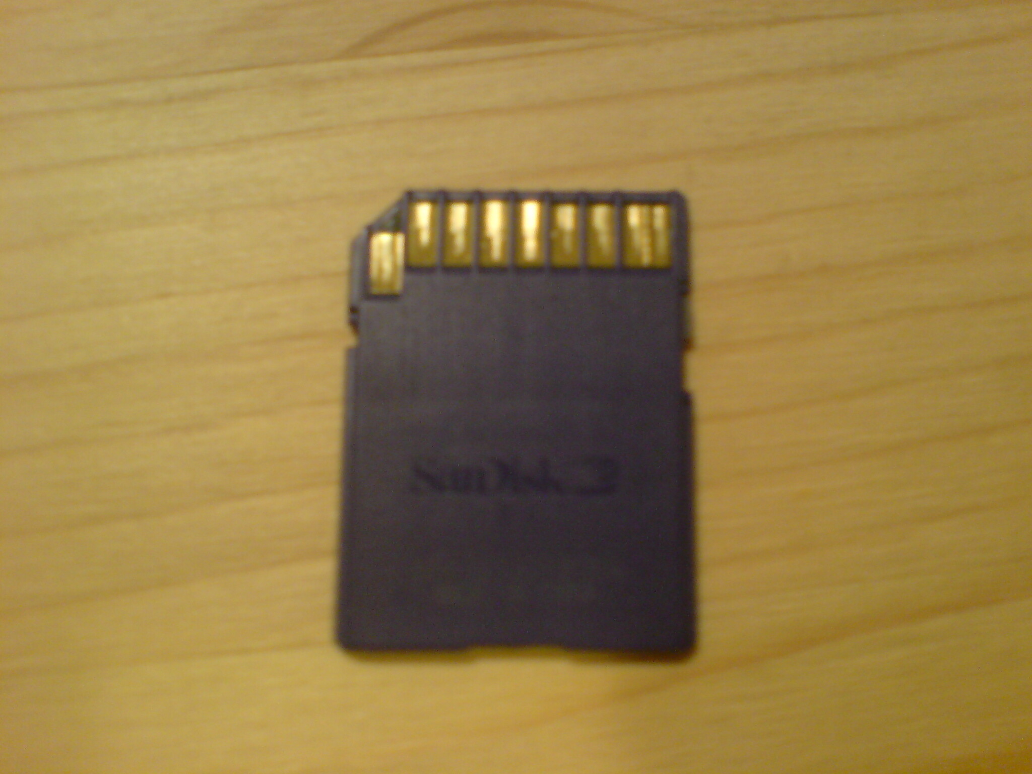

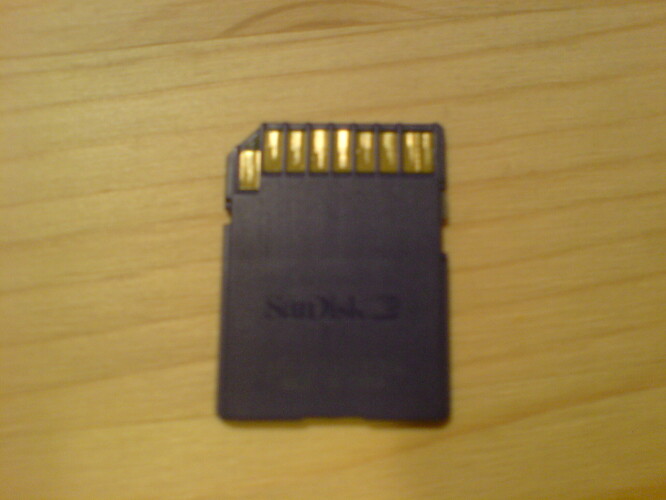

al_ra,
Mike has me a bit curious about your failed card. I have never seen a true SD card lockup on ACMD41. I have seen it with MMC cards and is to be expected since they they don't support ACMD41.
Could you provide a little more info?
How did you acquire it? There are many counterfeit cards on ebay that have modified firmware and often lockup. These cards are small but are reprogrammed to appear much larger and lockup after some use.
What is the brand?
What is the size in MB or GB?
What is the model for example SanDisk has Ultra, Extreme, etc. Other manufactures have other model names.
What is the class number? 2, 4, 6, 10 are common.
Add anything else you think might be helpful.
it is a genuine sandisk SD card, 1GB, I don't know the model (I added 2 photos)
