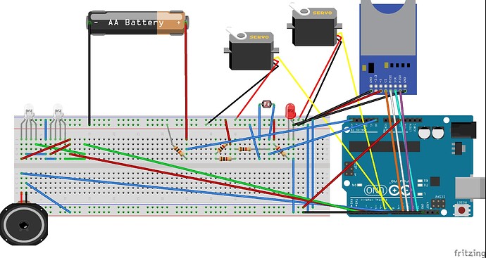

Hello, I am currently working on a project that I dubbed the T-Rex Battery tester. It essentially uses a dual SG90 servo sweep to clamp down on a AA battery on the base with contact pads on the top and bottom when it senses the battery is in the holder using a photocell. Then I had my code set up to test the voltage of the battery using an analog input and have some RGB LEDs switch from red to green and also have the SD card play a small T-Rex roar if the battery was good according to if statement values in serial monitor. The problem is that now for some reason the SD card shows up as failing every time in Serial Monitor and this essentially voids most of my project. I used a multimeter and found something around 3.7 volts going to the module when I connected the positive lead of the multimeter to the 5v pin and ground on the module. I believe this is correct, but I still cannot figure out what the heck is going on!
Here is my code:

Also attached is my current breadboard setup I made with Fritzing. Thanks!
What did you change/add to make the SD card start failing?
Power the servos and SD card with an external power supply.
