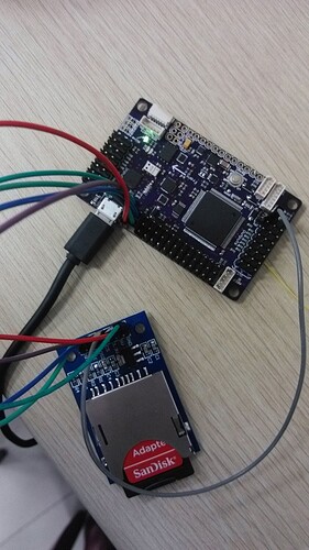

I wiring MISO -- PIN 50
MOSI -- PIN 51
SCK -- PIN 52
CS -- PIN12
and pinMode(53, OUTPUT);
Can you help me?Thx!

There is not other devices connected to the Mega, only SD card.The SDcard CS is connected to PIN 12(OUT 1).
And I used the 5V to power the SDcard.

I have heard on this forum that some of the SD card modules with the voltage divider circuit rather than a true logic level converter can cause problems. As I recall, it is a signal rise and fall time challenge with the larger, newer uSD cards due to the rc component of the circuit. Maybe fat16lib or someone else can add more to that.
Mine has a logic level converter.
Yes, those resistors (R1-R4) in the bottom picture. Unless my eyes are failing (that is possible..I'm old!), those particular resistors are 10Kohm. That will add a considerable rise and fall time delay.

This looks like an SD socket that is in many ebay ads.
This card has 10k resistors connected between 3.3V and CS, SCK, MISO, and MOSI. This may not work with many SD cards when the SPI is driven by 5V signals.

They are trying to tell you that the resistors are in series with the signals MOSI, SCK, and CS. This is because the arduino signals are 5V and the SD card is 3.3v. Yes, you are powering it with 5V, but there is a regulator on your module that brings it to 3.3V. That does not change the signals, though. So some cheaper modules use resistors in series to do the level translation between the 5V and 3.3v.
They are pointing out that this may cause problems. A more correct way to do it is to use a level translator IC like a CD4050 or 74HC244.

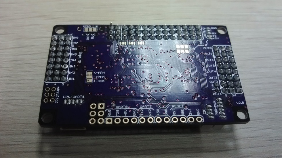

But... on your Arduino board, I see a jumper for selecting between 3.3v and 5V MISO levels. Perhaps you need to jumper that.
Actually, Retroplayer, I thought that too, but it is worse than that. The schematic fat16lib posted a link to above shows those 10K resistors are pullup resistors, not in series with the inputs. The 5v outputs of the Arduino are connected directly to the 3.3v inputs of the SD card.
Ahh... well, I looked at the schematic for the arduino board the OP is using and it appears that it has a level translator built in so the signals should be 3.3V. A pretty nice (but expensive board) actually.
