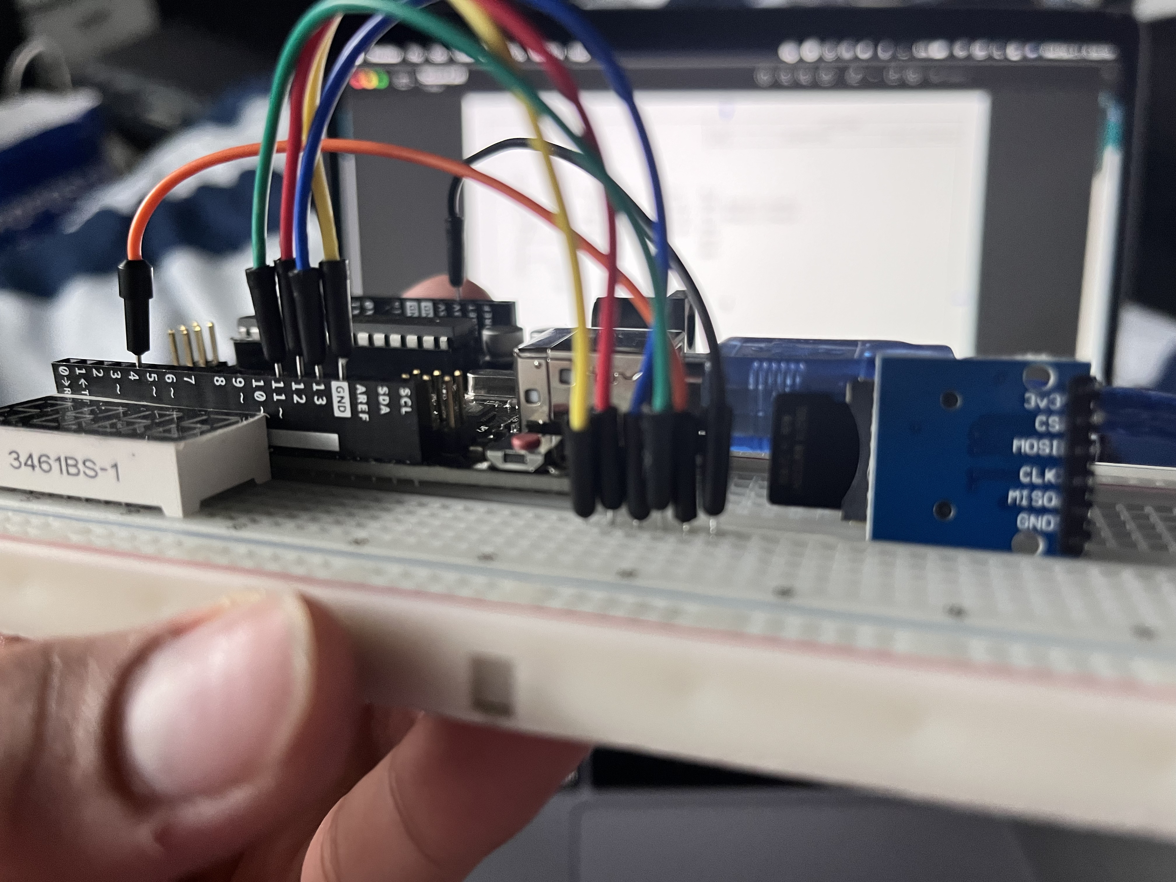

Show us your wiring. Here's mine.
SDcard.pdf (37.1 KB)
here you go, black wire is 3v and it all goes down in order lf the module (as seen on the right)
Doesn't reall sh9ow the actual wiring. A top view would be better. Also, can you hand draw a schematic of what you planned please.
Its just directly wired up to the GPIO pins in the Arduino a schematic is not really needed :))) also im like half asleep
