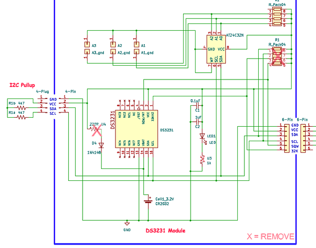

Also, I'm not sure it matters, and it's not the cause of the problem, but I think technically the RTC should be powered with 5V if it's communicating with a 5V Arduino. However, if you do that, you'll need to disable the "charging" circuit on the module if your backup cell is a normal CR2032.
https://www.onetransistor.eu/2019/07/zs042-ds3231-battery-charging-circuit.html

The ZS-042 for one thing assumes a rechargeable coin cell so if you insert a NON rechargeable cell you will get a nasty surprise.
Once I learn something I dpn't keep all the links and references since I have been doing this for nigh on 60 years and the piles of 'stuff' would overwhelm me and my computers. This one is however easy. Warning, you need to follow many links in many directions to get the entire 'flavour'. Some hints are traces need to be cut, pull ups need to be removbed and new pullups soldered. So much easier to just buy a Chronodot or a raw DS3231 chip. https://thecavepearlproject.org
That model nr wasn't the same as in the link OP provided. Expect when zooming in... You're right, there are info, and at least one thread in this forum that confirms this. So there's a misunderstanding, I'm sorry.
When I was researching I found lots of links (not on this forum) and I was shocked that everyone was calling the ZS-042 a DS32xx (xx can be 20 to 31 or more, just enhancements) There is a DS3231 on the ZS-042 but there is also EEPROM, a recharge circuit and issues around pullups. Have a close look at the ZS-042 and a Chronodot V2.0, 2.1, 3.0 to see the differences. I will try to add a picture of a ZS-042 undergoing required surgery if I can find one.
I noticed, not sure why one would want that when getting a RTC. And for the rest of the mess.. it's a bit messy :wink:
The latest Chronodot V3.0 has added an EEPROM. I guess there are enough use cases that require data to be remembered across a deep sleep to warrant it. At least with the Chronodot it's optional. Here is a video showing the surgery needed for a ZS-042 https://youtu.be/rG50U6bQhYo?si=FQBSky4tANiaaD0Z and here is a diagram showing what traces need cutting, resistor packs removed and more.
