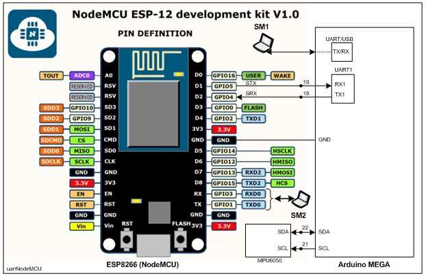

That means most probably you have a hardware problem. Post a wiring diagram of your complete setup!
TWCR = 0;
Never do that! You either use the Wire library to handle the I2C interface or you use the low level registers. If you mix the two you probably get more problems than you can handle. The above code is definitely wrong which shows that you don't know enough about the hardware registers to modify them yourself.
I have attached complete diagram. I don't think this is hardware issue since it works fine if I comment out either code for I2C communication or Serial communication! It hangs only if both I2C and serial communication are enabled. Maybe power supply could cause this issue, but not sure since I have both modules powered up from board the entire time. Maybe power consumption is much higher if they are processing communication. Board is equipped with standard AMS1117 which can provide enough power I guess.

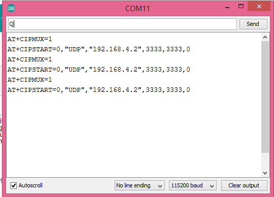

@OP
I have not encountered any problem to operate MPU6050 and ESP8266 simultaneously using I2C Bus and UART1-SUART Port. (I added for my own shake few lines of codes with your program). Look at the following Serial Monitors. The MEGA is acquiring signal well from 14-registers of MPU6050 and printing them on its Serial Monitor; the MEGA is also acquiring signal from ESP using Serial1 Port and printing the received character (Q) on the Serial Monitor. The ESP is also receiving messages from MEGA and printing them on its Serial Monitor.

ESP-Codes:
#include<SoftwareSerial.h>
SoftwareSerial mySUART(4, 5);  //D2, D1 = SRX, STX
  mySUART.begin(115200);
  if (Serial.available() > 0)
    byte x = Serial.read();
    mySUART.write(x);
  if (mySUART.available() > 0)
    Serial.write((char)mySUART.read());
